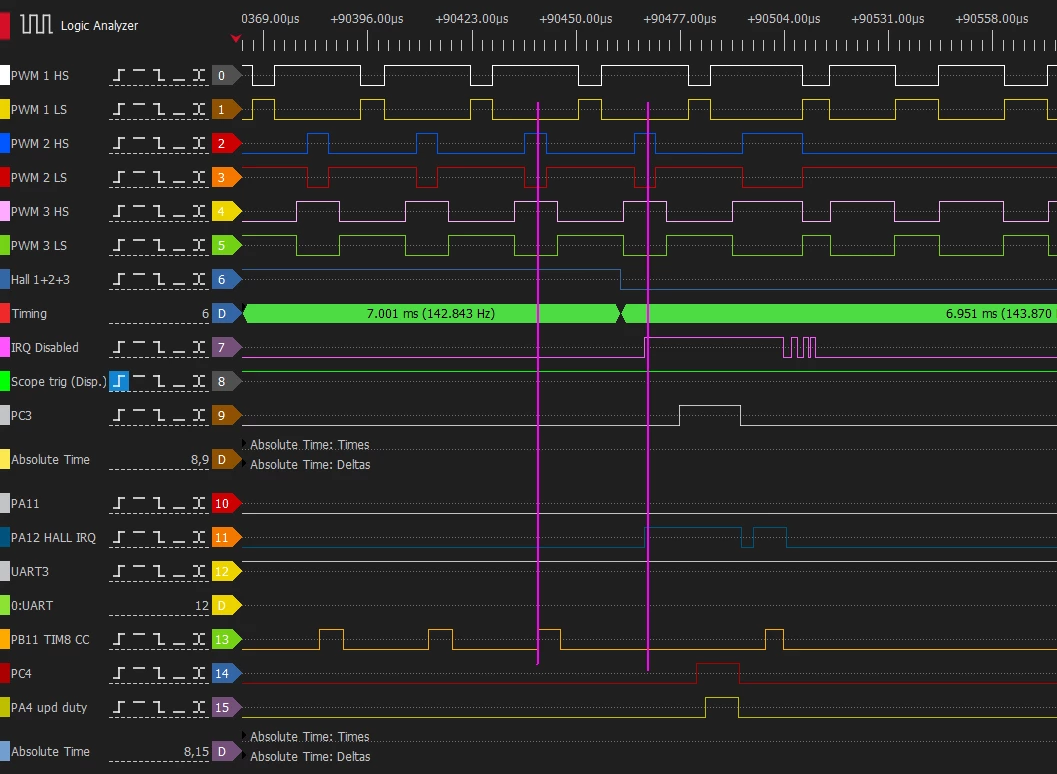

Disabling interrupts and clearing flags (TIM8 CC4) - Only working when interrupts are enabled?
I have quite a complicated case, where a interrupt is beeing executed, allthough it has been disabled, and its flag beeing cleared. At the same time interrupts are disabled, and i put a few nops in between just to rule out any delay related issues. The disabling of the interrupt works, but there is just one afterwards that i cant get rid of.
For now i just would like to know, if anyone has any idea if the title can be answered with yes. (And if there is a explanation why that is)
I would have liked to try a minimal code, but its quite complicated and i am afraid the error can then not be reproduced. Timers are interconnected too.

This is how i clear it:
CLEAR_BIT(TIM8->DIER, TIM_DIER_CC4IE);
30 NOP´s
TIM8->SR = ~TIM_SR_CC4IF;
30 NOP´s
other code
SET_BIT(TIM8->EGR, TIM_EGR_COMG); //should not matter here
delayMicros(2);

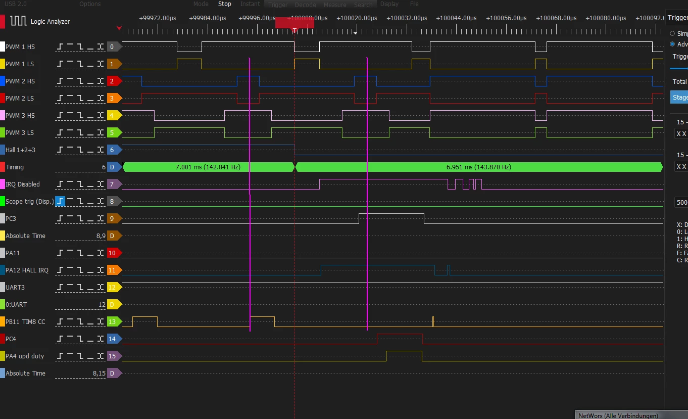

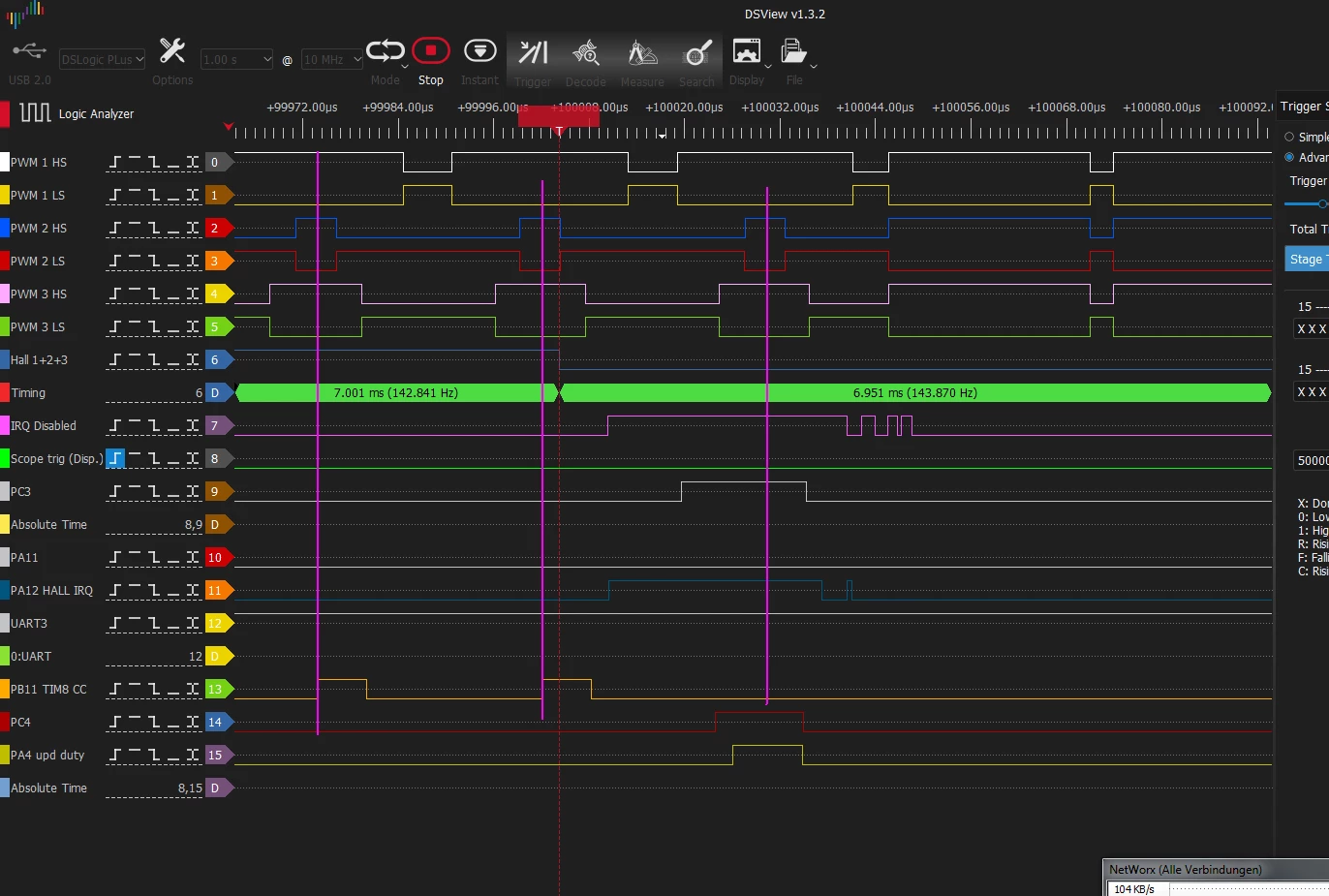

When i enable interrupts before the delay, the interrupt does not get fired again, if i enable interrupts after, it does get fired again. See the picture for timing illusatration:
  • PC4 is the actual clearing (first 5 lines of code above).
  • PB11 is the problem interrupt
  • Pink lines show interrupt times
  • PA12 is the interrupt, that (should) disables the problem interrupt
  • Ignore the "IRQ Disabled" channel, as it has some issue and is not valid
