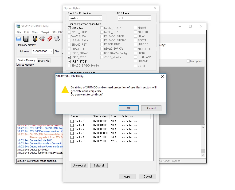

Is there a way to disable the ''Flash sectors protection'' through USB (DfuSeDemo/dfu-util/...)?
It can be done using the STM32 ST-LINK Utility,
by going to Target > Option Bytes, and unselecting all the sectors under ''Flash sectors protection''
and pressing Apply.
Note that the sectors were Read/Write Protected.
As described in the last post on this topic:
https://community.st.com/message/60940
I would have to put the chip protection level to 1 and switch it back to 0 while changing the PCROP bit.
How would i go about doing this through the dfu-protocol or is this not possible.

    I have received an answer from ST
    (...) this is not possible with system DFU bootloader.
    As you can find in reference manual for F401 (RM0368 rev4) page 58:
    'The deactivation of the SPRMOD and/or the unprotection of PCROPed user sectors can only occur when, at the same time, the RDP level changes from 1 to 0'
    And system bootloader is not accessible when RDP>0, so it's not possible to perform this action.
