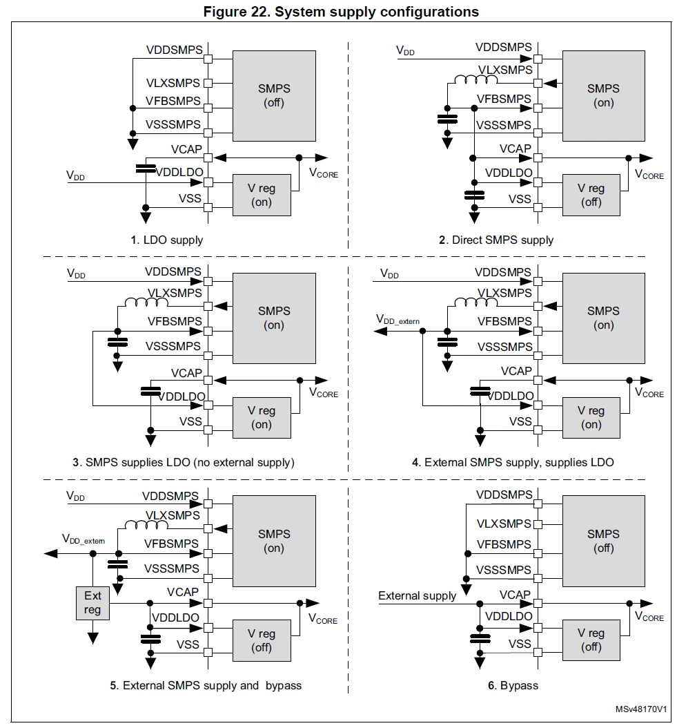

Disable internal SMPS by Harware STM32H755IIT
Well I tried to read the documentation, but found only HW requirements to use SMPS. So is the SMPS required?
Or can the SMPS just tie VDDSMPS, VLXSMPS, VFBSMPS and VSSSMPS to ground directly on PCB when no needs for that?

Dec 27, 2020 3:36 PM UTC
You are not required to use SMPS. The power supply options and how to connect pins in each case are outlined in the reference manual.
