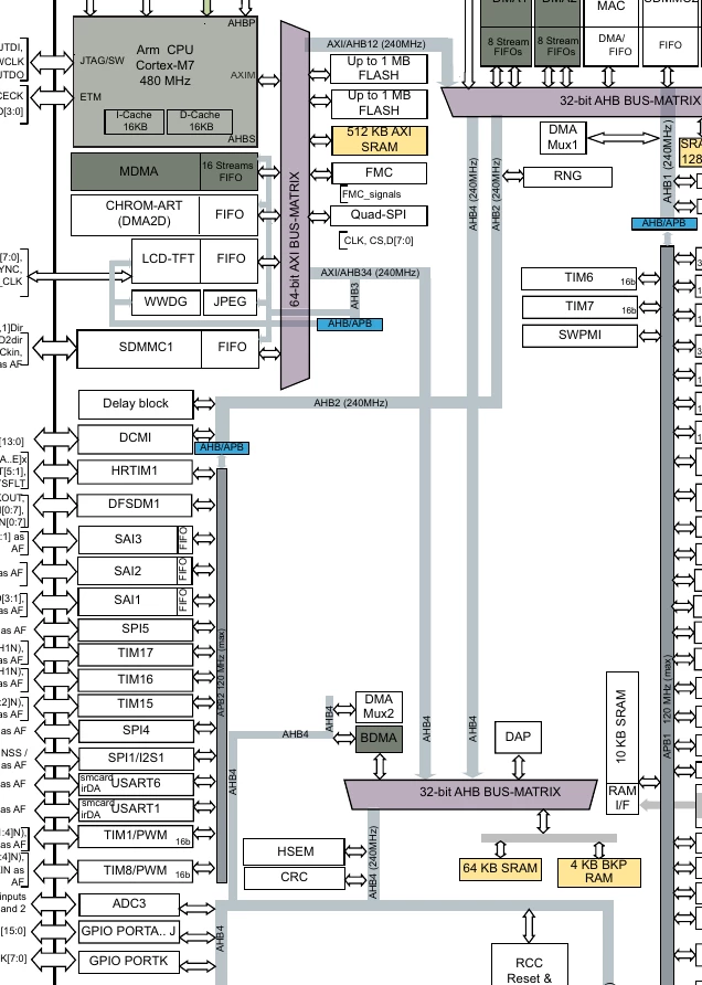

Hello, as part of my master's, I am required to process information received from some electronic system, I need to read 36 bits (output of 3 12 bit ADC) at the same time and process them and perform calculations and for that I need execution speed. I chose STM32H743ZGT6 and I wanted to know if ports B,D,G,E in this microcontroller have direct access to SRAM memory for fast reading of the ports and the possibility to process them after 4 clock cycles? That is, they will be stored in SRAM after 4 clock cycles

for really fast port access - the H7 is not the best choice. (very complex architecture, ports "far away" from core/ram)
Ports are on AHB4 bus and so on its speed there...see ds .
Well, maybe ... fastest i got : 25ns at 200M core , so 5 core clks.
You will use DMA for this - right ? So just try (I didnt.), how many clks to RAM.
Maybe using BDMA -> to local 64KB RAM, it could be very fast (1 AHB4 clk , 4ns ?) and it dont block core, working on other RAM ....try it! and tell... :)

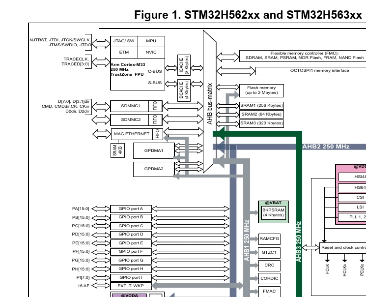

Compare with a H563 , i got : 4ns at 250M core, so 1 core clk.
Here ports on AHB2 bus with direct access  from core :
So a "more simple" architecture much better for a "simple" port access from core.
