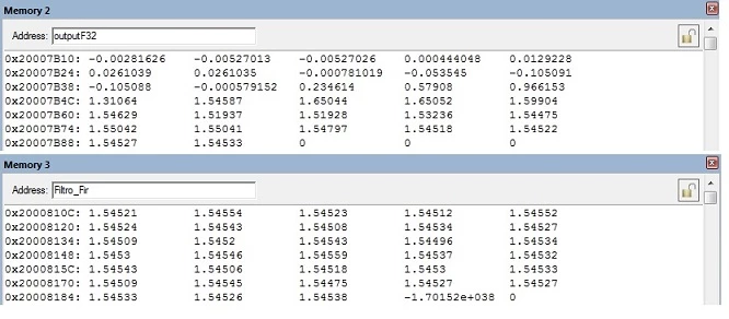

I am using the DSP Library to make a Fir Filter with STM32F407 and uvision4. The example work fine and the data is right comparing with matlab. Now I am trying to make it work in a real time application. So I use a circular buffer as input for the function and a DC sinal as data. The sequency is: Obtain a sample, move it to circular buffer and execute thearm_fir_f32 function. I wanna know if this steps are right for a real time filter and I dont understand what is my output because the ''outputF32'' is a buffer with 32 numbers half of it is almost zero.

Here is my output data and my input buffer: 0690X00000603GkQAI.jpg

    Now i realized that  variable ''
    blockSize
    '' is the size of  the output.
    When I put it in value 1 the answer is always arround -0.0028

    I put the output buffer from position 16 to 32 into a DAC and the filter is working fine.
    :D
    I just dont understand why the first parameters appear almost zero.
