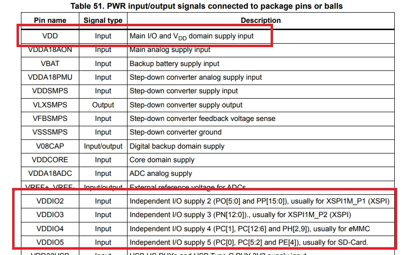

I guess VDD is independent from VDDIOx and supplies all GPIO that are not in the scope of VDDIOx, correct?
mƎALLEm
May 21, 2025 2:24 PM UTC
Yes VDD is independent from VDDIOx. Some IOs are power supplied from the VDD rails others from VDDIOx.
The VDD/VDDIOs distribution is described in the table 51 in the reference manual of the product::
