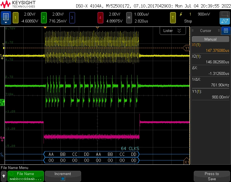

different behaviour of my chip select with different payload size

when I'm running a single SPI transaction using
HAL_SPI_TransmitReceive i have different behavior with different payload size:
when i am use samll payload = "aabbccddaabbccdd" then i get the following:
but when i am using larger payload = "aabbccddaabbccddaabbccdd" then i get the following:0693W00000QKNu6QAH.png
can someone please explain why there is different behavior of the chip select with the number of cycle clocks?

waclawek.jan
Jul 4, 2022 8:08 PM UTC
For continuous back-to-back transmission, use DMA.
Alternatively, don't use the "automatic" hardware NSS, but set it as a GPIO output and toggle it "manually".
VKats.1
VKats.1Author
Jul 5, 2022 10:52 AM UTC
thank you for the answer.
what do you mean by "continuous"?
as you can see in the picture only the size of the payload is different.
and for some reason, the first 8 bytes are "connected"
Piranha
Principal III
Jul 5, 2022 12:01 PM UTC
hspi4.Init.FifoThreshold = SPI_FIFO_THRESHOLD_08DATA;
Those are filled before the transmission starts.
waclawek.jan
Jul 5, 2022 11:41 AM UTC
The same what you call "connected".
