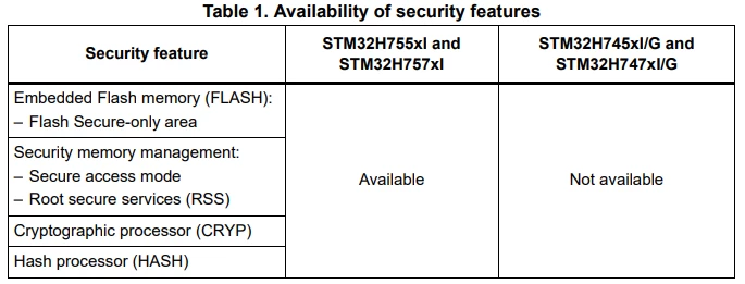

Differences between STM32H745ZIT3 and STM32H755ZIT3
Could you share differences between STM32H745ZIT3 and STM32H755ZIT3? Is it only the security functionalities which are different? Request to share comparison table for same.

Hello @RSing.4​ and welcome to the community  ,
The difference between the STM32H745ZIT3 and STM32H755ZIT3 is only the security features.
The below table shares the availability of security features in STM32H745 and STM32H755.
_legacyfs_online_stmicro_images_0693W00000dJpXtQAK.pngFor more security information, I recommend you to take a look to M0399 and precisely Secure memory management (SMM), Cryptographic processor (CRYP) and Hash processor (HASH) Sections.
