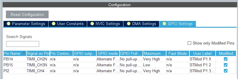

I think I am missing something obvious about a difference between channels 2&3 vs channel 4 in the TIM8 after staring at this for some hours now...
I am using the STM32H750 discovery board, and created a project in CubeMX which configures PI2, PB14 and PB15 as PWM outputs for channels 4, 2, 3 of timer 8. (ignore the maximum frequency, I changed it after taking this screenshot)

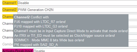

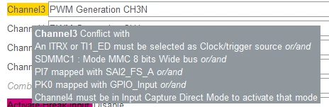

CubeMX provides a warning about a conflict for PB14 and PB15 assignment, but I can't tell which potential conflict is the real one.

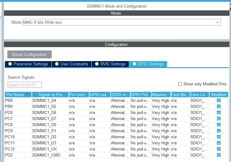

The SDMMC is enabled but not using these pins:

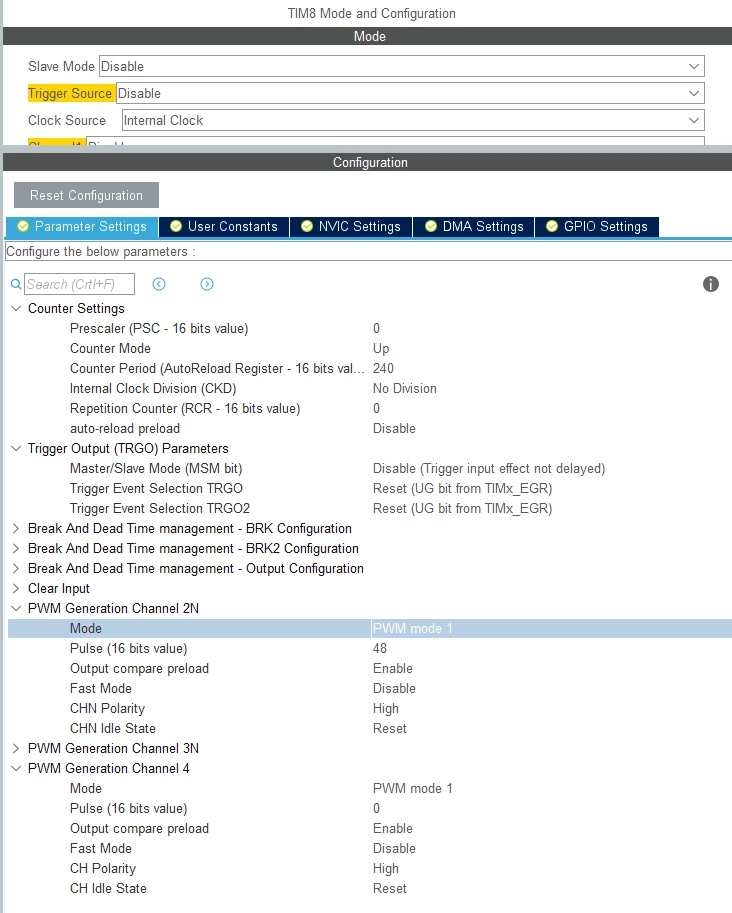

Break and dead time functions are all disabled in the configuration. Looking in the description of the timer in the reference manual (figure 344 of RM0433) it seems like these channels should be configured with the same behaviors. But when I run my program (even just using the default PWM duty cycle I have configured in the CubeMX) the pins PB14 and PB15 have no PWM output.

This is the timer initialization, as generated by CubeMX:
static void MX_TIM8_Init(void)
 /* USER CODE BEGIN TIM8_Init 0 */
 /* USER CODE END TIM8_Init 0 */
 TIM_ClockConfigTypeDef sClockSourceConfig = {0};
 TIM_MasterConfigTypeDef sMasterConfig = {0};
 TIM_OC_InitTypeDef sConfigOC = {0};
 TIM_BreakDeadTimeConfigTypeDef sBreakDeadTimeConfig = {0};
 /* USER CODE BEGIN TIM8_Init 1 */
 /* USER CODE END TIM8_Init 1 */
 htim8.Instance = TIM8;
 htim8.Init.Prescaler = 0;
 htim8.Init.CounterMode = TIM_COUNTERMODE_UP;
 htim8.Init.Period = 480;
 htim8.Init.ClockDivision = TIM_CLOCKDIVISION_DIV1;
 htim8.Init.RepetitionCounter = 0;
 htim8.Init.AutoReloadPreload = TIM_AUTORELOAD_PRELOAD_DISABLE;
 if (HAL_TIM_Base_Init(&htim8) != HAL_OK)
 Error_Handler();
 sClockSourceConfig.ClockSource = TIM_CLOCKSOURCE_INTERNAL;
 if (HAL_TIM_ConfigClockSource(&htim8, &sClockSourceConfig) != HAL_OK)
 Error_Handler();
 if (HAL_TIM_PWM_Init(&htim8) != HAL_OK)
 Error_Handler();
 sMasterConfig.MasterOutputTrigger = TIM_TRGO_RESET;
 sMasterConfig.MasterOutputTrigger2 = TIM_TRGO2_RESET;
 sMasterConfig.MasterSlaveMode = TIM_MASTERSLAVEMODE_DISABLE;
 if (HAL_TIMEx_MasterConfigSynchronization(&htim8, &sMasterConfig) != HAL_OK)
 Error_Handler();
 sConfigOC.OCMode = TIM_OCMODE_PWM1;
 sConfigOC.Pulse = 48;
 sConfigOC.OCPolarity = TIM_OCPOLARITY_HIGH;
 sConfigOC.OCNPolarity = TIM_OCNPOLARITY_HIGH;
 sConfigOC.OCFastMode = TIM_OCFAST_DISABLE;
 sConfigOC.OCIdleState = TIM_OCIDLESTATE_RESET;
 sConfigOC.OCNIdleState = TIM_OCNIDLESTATE_RESET;
 if (HAL_TIM_PWM_ConfigChannel(&htim8, &sConfigOC, TIM_CHANNEL_2) != HAL_OK)
 Error_Handler();
 sConfigOC.Pulse = 32;
 if (HAL_TIM_PWM_ConfigChannel(&htim8, &sConfigOC, TIM_CHANNEL_3) != HAL_OK)
 Error_Handler();
 sConfigOC.Pulse = 24;
 if (HAL_TIM_PWM_ConfigChannel(&htim8, &sConfigOC, TIM_CHANNEL_4) != HAL_OK)
 Error_Handler();
 sBreakDeadTimeConfig.OffStateRunMode = TIM_OSSR_DISABLE;
 sBreakDeadTimeConfig.OffStateIDLEMode = TIM_OSSI_DISABLE;
 sBreakDeadTimeConfig.LockLevel = TIM_LOCKLEVEL_OFF;
 sBreakDeadTimeConfig.DeadTime = 0;
 sBreakDeadTimeConfig.BreakState = TIM_BREAK_DISABLE;
 sBreakDeadTimeConfig.BreakPolarity = TIM_BREAKPOLARITY_HIGH;
 sBreakDeadTimeConfig.BreakFilter = 0;
 sBreakDeadTimeConfig.Break2State = TIM_BREAK2_DISABLE;
 sBreakDeadTimeConfig.Break2Polarity = TIM_BREAK2POLARITY_HIGH;
 sBreakDeadTimeConfig.Break2Filter = 0;
 sBreakDeadTimeConfig.AutomaticOutput = TIM_AUTOMATICOUTPUT_DISABLE;
 if (HAL_TIMEx_ConfigBreakDeadTime(&htim8, &sBreakDeadTimeConfig) != HAL_OK)
 Error_Handler();
 /* USER CODE BEGIN TIM8_Init 2 */
 /* USER CODE END TIM8_Init 2 */
 HAL_TIM_MspPostInit(&htim8);

Read out and check the TIM and relevant GPIO registers. I'd bet you don't have CH2N and CH3N enabled in TIMx_CCER (CC2NE/CC3NE bits). IIRC there is some Cube incantation for this, from the Ex group.

Fantastic, thanks to you both! It was indeed the CCxNE bits not being set. Since I'm using CubeMX & HAL, I had called HAL_TIM_PWM_Start() for all channels, but really needed to call HAL_TIMEx_PWMN_Start() for channels 2 and 3 using the complementary outputs. That sets the CCxNE bits properly. Thanks!
