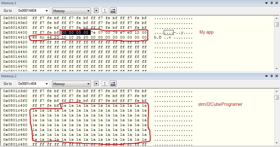

Hello!
i have been working on an application which allows me to flash a binary file into the MCU memory and thus
updating the firmware application.
When i flash the .bin file using my app i am able to transfer the file but its ending is different from
the one flashed by the 'stm32CubeProgrammer' as shown in the attached snapshot. please note that
besides the ending all other bytes are the same.
i am working with the stm32f7 on IAR embedded workbench version 8.11, the .bin file is created
the IDE's output converter.
What's the meaning of this file ending? is this some sort of checksum? am i doing something wrong?
please advise.

    Does your bin file actually end with FF F7 FE EF or 00 00 00 00 ?
    (view in a decent binary editor)
    -- pa

    it does end with FF F7 FE BF  ...

    Then, in your app pad the data up to 64 bytes boundary (it looks so) with 1A, and it will be same as with the
    stm32CubeProgrammer.
    -- pa

    0x1A (26) is a frequent end-of-file marker, likely to see in X-MODEM type methods as a fill character for 128 or 1KB packets.
