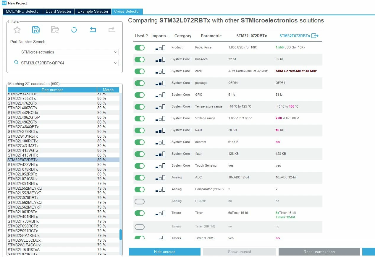

Please help to check and advise difference between STM32F072RBT6 and STM32L072RBT6? Also, can they be used as replacement to each other?

As proposed by @Uwe Bonnes​ , you can download and use ST-MCU-FINDER tool (feature included also in the STM32CubeIDE and STM32CubeMX tools.) to compare the characteristics of two or more MCUs through the "Cross Selector" tab.
Please have a look at the attached Excel file.

They are quite different. Check ST MCU Website. ST MCUFinder and datasheets
