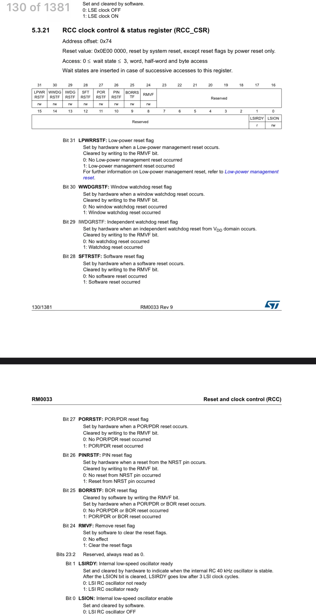

I have below questions:
1. Using NRST pin make LOW which flag would be SET in firmware?
2. If we do board power ON and OFF, which flag would be SET in firmware?
