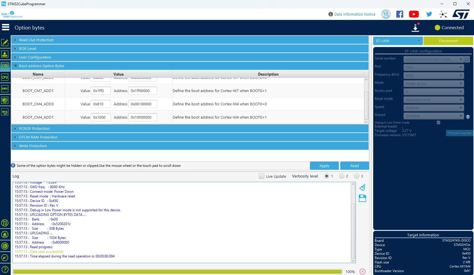

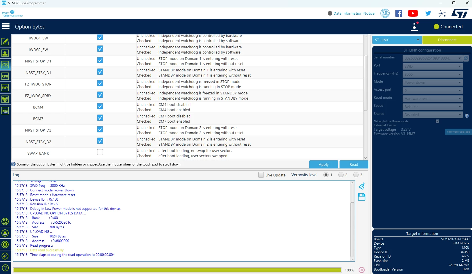

Check if you have disabled the Cortex-M4 using CubeProgrammer in option bytes menu.
FabianEbsAuthor
August 26, 2024
Hi @mƎALLEm , thanks for your reply!
The M4-Core is enabled and the address should also be fine:

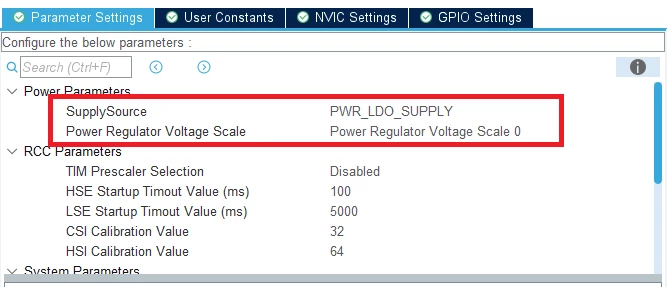

Here is the ioc-file that broke the board, not sure what is wrong with it, i didnt dare test it on another board yet. Will do now though.
mƎALLEm
August 26, 2024
Indeed this is a wrong configuration with your RCC:
First, STM32H745I-Discovery is mounted in SMPS by HW while you set the power config to LDO.
Second, you cannot exceed 400MHz @VOS1 in SMPS with that microcontroller.
Attached an updated ioc file. Please test and get back with your findings.
