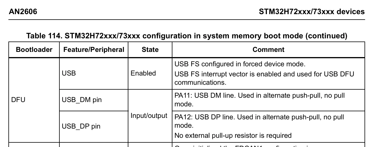

Hi I wanted to make a flight controller using stm32h723zgt6. My question is can this MCU have Usb virtual com port so I can use dfu Mode

Yes, it supports USB DFU as noted in AN2606.
Do yourself a favor and use SWD during development and debugging.
