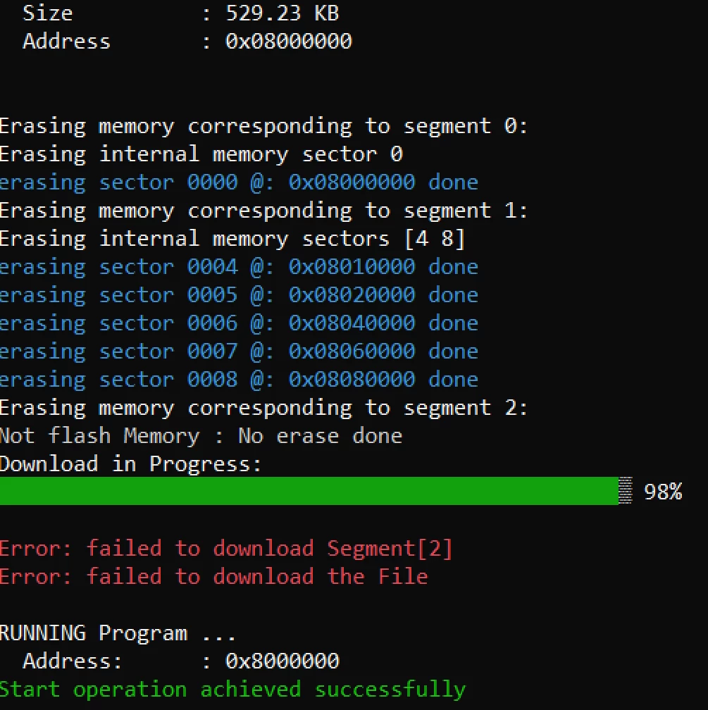

I use CLI for flash F469 and same hex file flashed over SWD without error produce over DFU this. 0693W00000YAhtuQAD.pngis this know issue ? Seems code is ok after both loads.

I test HEX and ELF file, and seems here linker generate section , but same file dont produce error if -c SWD is used.

and i dont understand why this section is in . Maybe my linker file need add somethink i use CCMRAM for some arrays. now is defined as
/* Memories definition */
MEMORY
 FLASH0 (rx) : ORIGIN = 0x08000000, LENGTH = 16K	/* FL1 zatial isr */
 CCMRAM (xrw) : ORIGIN = 0x10000000, LENGTH = 64K
 RAM (xrw) : ORIGIN = 0x20000000, LENGTH = 320K
 FLASH (rx) : ORIGIN = 0x8010000, LENGTH = 1984K /* reserve EEPROM sec 1 2 3 used only 2 3*/
/* Sections */
SECTIONS
/* Added MM */
 .ccmram :
 . = ALIGN(4);
 _sccmram = .; /* create a global symbol at ccmram start */
 *(.ccmram)
 *(.ccmram*)
 . = ALIGN(4);
 _eccmram = .; /* create a global symbol at ccmram end */
 } >CCMRAM
 /* The startup code into "FLASH" Rom type memory */
 .isr_vector :
 . = ALIGN(4);
 KEEP(*(.isr_vector)) /* Startup code */
 . = ALIGN(4);
 } >FLASH0
... rest no changes
2 replies
Tesla DeLorean
Guru
February 14, 2023
Where's the data going?
SRAM at 0x20000000. CCMRAM at 0x10000000
There shouldn't be any of that in the .ELF file / sections, as the startup.s code should be copying initialization data out of Internal FLASH
What other sections is the DFU file describing?
MEMORY
/* Sections */
SECTIONS
/* Added MM */
 .ccmram :
 . = ALIGN(4);
 *(.ccmram)
 *(.ccmram*)
 . = ALIGN(4);
 } >CCMRAM
 .isr_vector :
 . = ALIGN(4);
 . = ALIGN(4);
 } >FLASH0
... rest no changes
