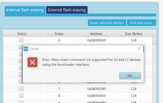

I can connect a STM32L073 via USB in in DFU mode to STM32CubeProgrammer but i can not programm the uController.
Reading device Memory and option bytes work, but programming does not.
What I do is:
  1.       Select a Hex file
  2.       Enable verify
  3.       Verbosity level to 3
  4.       Start Programming
Now I got Verification Error and erasing sectors does not work. See end of this post or Please See Output Log file. It shows up like the programm has been updated, but it was not. There is still the old programm starting.
Option Bytes shows that there is no write protection enabled.
It should not be that difficult !?
Please STM team, could someone of your dev team grab a STM32L073 Nucleo board and try to program it via USB DFU and post a step by step solution?

    Dear Aymen,
    sadly Full Chip erase is NOT supported for L0 and L1 devices using Bootloader interface! Thats why its not possible to programm the device. The developers for STM32cubeProgrammer forget to include a Button which selects all Sector Index checkboxes to be able to do use the singe sector erase for all sectors.
    in order to do a full chip erase the only working workauround L0 L1 devices is to select and then deselct the Read out Protection Flag, which will do a chip erase after deselect ROP flag. Performing that procedre it is possible to Programm L0 L1 devices via USB

    Please try to do a mass erase before launching hex programming.
