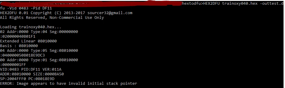

    Hi there,
    we are having the same issue with not matching addresses in DfuSe. We are using the STM32F746VG on a custom board. With the HEX2DFU converter we also get the same error with the initial stack pointer:0690X00000609aIQAQ.png
    We tried different configurations for _estack in the .ld file. Below is our current configuration but we also tried 0x20050000 and 0x2004FFFF.
    /* Highest address of the user mode stack */
    _estack = 0x2004FFF0; /* end of RAM */
    /* Generate a link error if heap and stack don't fit into RAM */
    _Min_Heap_Size = 0x200; /* required amount of heap */
    _Min_Stack_Size = 0x400; /* required amount of stack */
    /* Specify the memory areas */
    MEMORY
    RAM (xrw) : ORIGIN = 0x20010000, LENGTH = 320K - 0x10000
    FLASH (rx) : ORIGIN = 0x8010000, LENGTH = 1024K - 0x10000
    Do you have any ideas to get a valid initial stack pointer?
    Cheers
    Kevin

    Posted on February 05, 2018 at 15:03
    Actually it was my utility, might be the SRAM address is too high for the purposes of the sanity check.
    Could you try changing the address in the vector table in startup_stm32f7xyz.s?
    g_pfnVectors:
      .word  _estack   /* Change to 0x20002000 */
      .word  Reset_Handler
      .word  NMI_Handler
      .word  HardFault_Handler
      .word  MemManage_Handler
    The first instruction in Reset_Handler sets it to _estack so just needs a RAM bound address, probably at 128KB or below

    Hi all,
    I was trying to automate the generation of the dfu file using HEX2DFU (thanks Clive !) file but I got an error message regarding the stack pointer:
    >HEX2DFU.exe blink2.hex -out blink2.dfu
    HEX2DFU 0.01 Copyright (C) 2013-2017 sourcer32@gmail.com
    All Rights Reserved, Non-Commercial Use Only
    Loading blink2.hex...
    02 Addr:0000 Type:04 Seg:00000000
    :020000040801F1
    Extended Linear 08010000
    Basis : 08010000
    04 Addr:0000 Type:05 Seg:08010000
    :040000050801257D4C
    00 Addr:0000 Type:01 Seg:08010000
    :00000001FF
    VID:0483 PID:DF11 VER:011A
    ADDR:08010000 SIZE:00003720
    SP:20050000 PC:0801257D
    ERROR: Image appears to have invalid initial stack pointer
    but strange enough, nor "DfuSe demo" nor "DFU File Manager" (both at v3.0.6) complains about the stack pointer and even my USB bootloader (that opens an *.dfu from a mass storage device and flash it) seems to work fine... apps are loaded and launched w/o problems.
    My LD files are:

    iw2lsi
    April 1, 2019
    Hi Clive,
    I've found an old message where you suggest to reduce the RAM size...
    it works fine just by changing from the application's LD from:
    _estack = 0x20050000;
    to:
    _estack = 0x20002000;
    would it be possible for you to update HEX2DFU ?
    tnx
