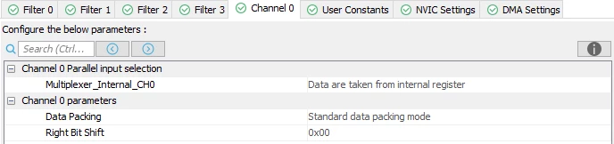

Channel0 is activated in the parallel mode, standard data packing mode and the setting to take data from internal register.

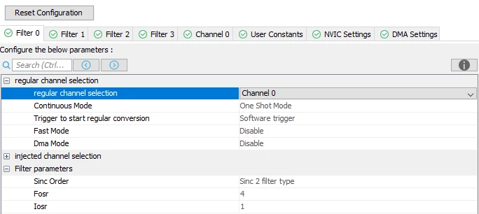

Additionally I mapped Filter0 to Channel0 and set it in one shot mode, software triggered, fastmode disabled, DMA disabled and setup the sinc filter parameter as mentioned before.

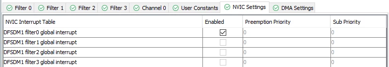

Finally enabled the global interrupt for Filter0.

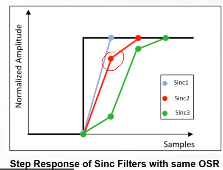

For example when giving constantly the value 1000 to convert, I would expect that the filter output reach the value 1000*FOSR^Order = 16000 after two sample cycles like illustrated in this graph:
That is not the case. I am missing the data point before reaching the final value 16000.
In addition, if I raise the filter order the output values are also jumping always from zero directly to final value without having the steps in between...
