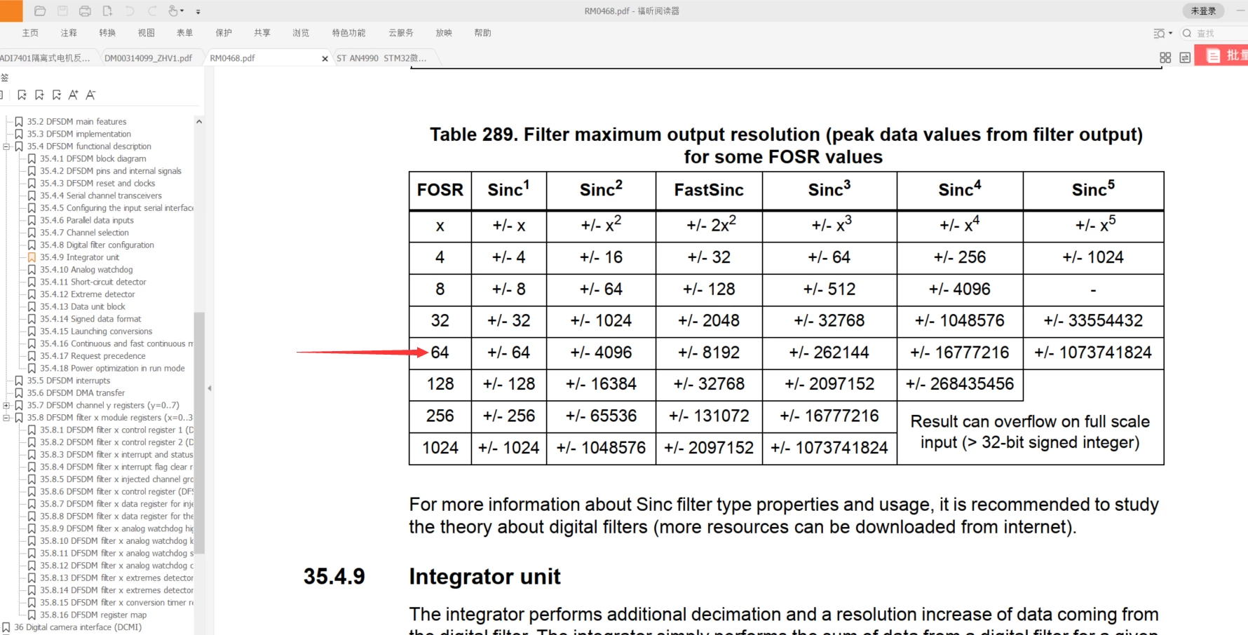

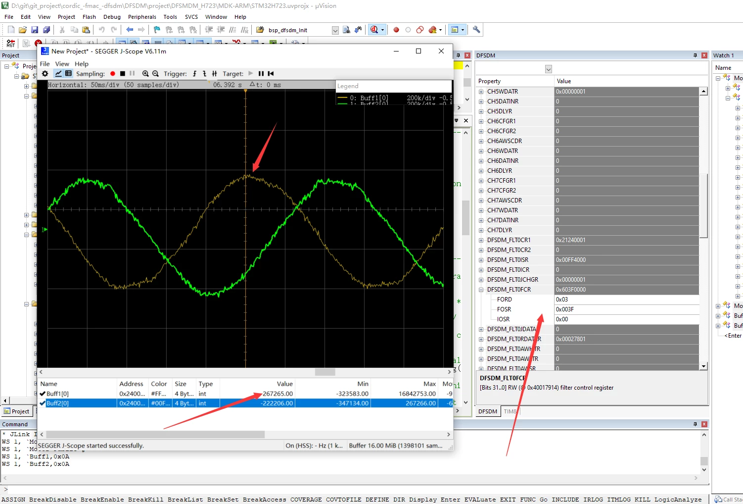

When I use DFSDM, I configure FOSR= 256 ISOR=1 and the output is outside the range in the reference guide +-16777216

 /* Regular conversion value is a signed value located on 24 MSB of register */
 /* So after applying a mask on these bits we have to perform a division by 256 (2 raised to the power of 8) */

The STM32Cube H7 package which providing DFSDM example,Only refer a applicableation About Audio
Can you verify the range of DFSDM output results at FORD=3 FOSR=256 ISOR=1 ?
