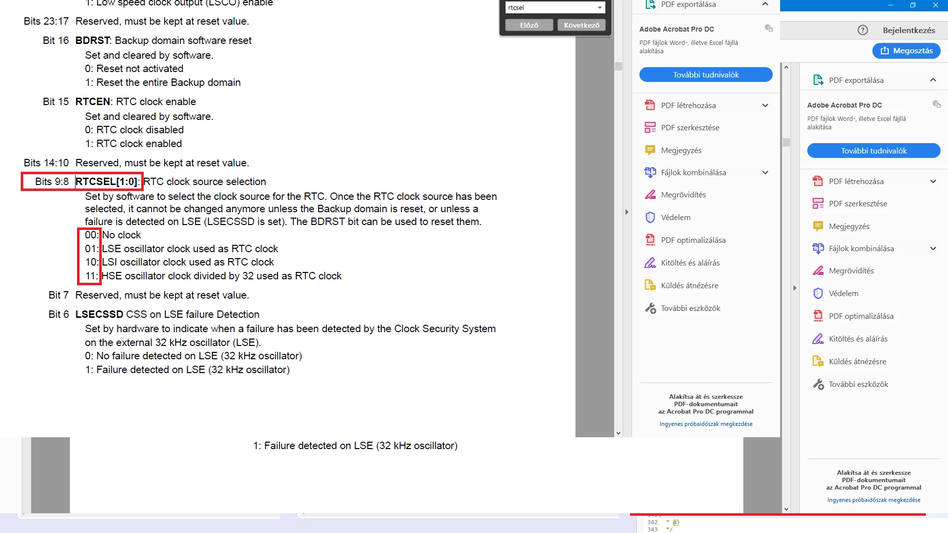

1 << 8 = 256 and not 255.
It's okay if LL_RCC_SetRTCClockSource does not perform a further shift (which you can look up in Cube's sources that it does not).

Yes, you're right. Please delete this thread, it's OK.I tried to write that value into RTCSEL bits which is only 2 bit long. :grinning_face_with_sweat:
