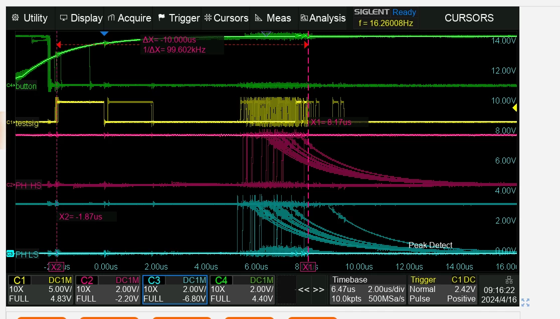

Delay of interfacing timer is rather inconsistent
  • April 16, 2024
  • 1 reply
  • 858 views
I have implemented a hallinterface (tim 1), to update my pwm timer (tim 8). But the delay i set is rather fluctuating.
Disabling interrupt inside of the tim 1 interrupt did not help. And i think, outside of the interrupt it should not matter, since this is only hardware that is not influenced by software really? At least i would not think that it should fluctuate in a scale of about 2us.

Please find attached the curves:
Yellow curve: First pulse is of timer 1 interrupt. Second + third is Interrupt of timer 8.
Red and blue curve: Outputs of timer 8
Green line: input of timer 1 input cpature
Best answer by Tobe
While writing this topic, i found the issue myself: The prescaler counter had to be reset too:
TIM1->EGR = TIM_EGR_UG;	// reset prescaler counter (through update event)
1 reply
Tobe
TobeAuthorBest answer
Senior III
April 16, 2024
