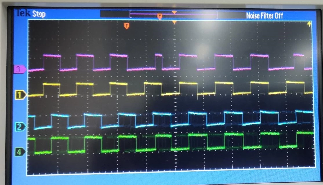

The oscilloscope trace is as follows:
Now here the the channel 3 is supposed to follow channel 1 and Channel 4 is supposed to follow channel 2... but as you can see there is an instance in channel 3 where there is a considerable delay (right around the middle) which is almost 60us... this is a random behavior and the delay values also vary. this ideally shouldn't happen.. even worse case issue is when the delay exceeds the next edge change, in which case i can totally miss an edge.
i am using this to calculate the number of edges so this is causing a lot of issues.
Can anyone throw some support on this to identify the reason for delay in processing the GPIO interrupts.
