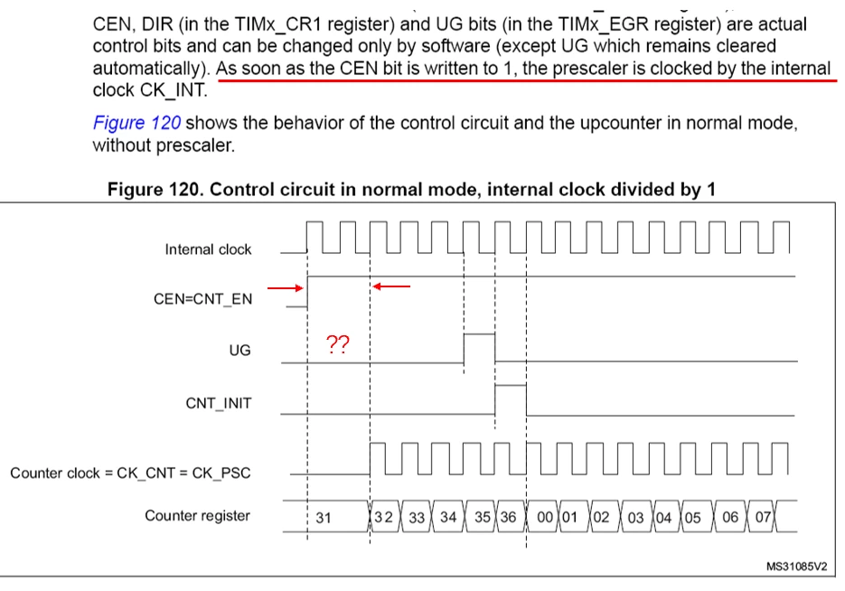

Delay from CKT_EN to CK_CNT
  • March 20, 2020
  • 3 replies
  • 3315 views
In the RM0008, Figure 120 on page 379, it says "as soon as the CEN bit is written to 1, the prescaler is clocked by the internal clock, CK_INT. " as shown below. However in the figure, the CK_CNT appears 2 cycles after the CEN bit became 1. Given the prescale ratio of 1, I wonder how to explain that there are 2 cycles before the CK_CNT follows the response.

waclawek.jan
March 21, 2020
IIRC this or similar question has been discussed here maybe last year, and even answered by ST insider. Try searching the forum.
