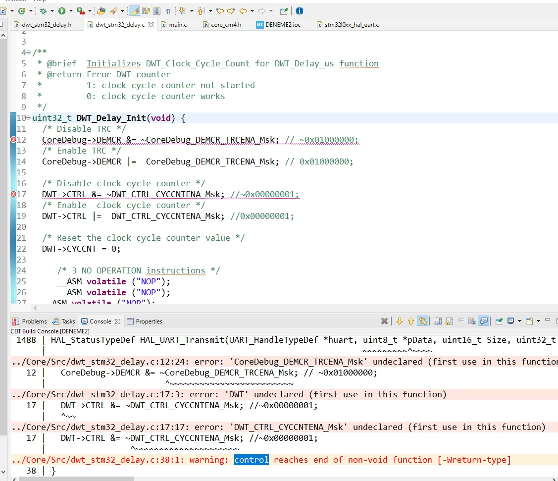

Hi, my processor is STM32L010C6TX. I added function to my project to use microsecond But " DWT" "CTRL" etc. It says not defined. However, they are all in the "core_cm4.h" library. This library is in Drivers-> CMSIS->Include. why doesn't it call this function and say "undeclared"?

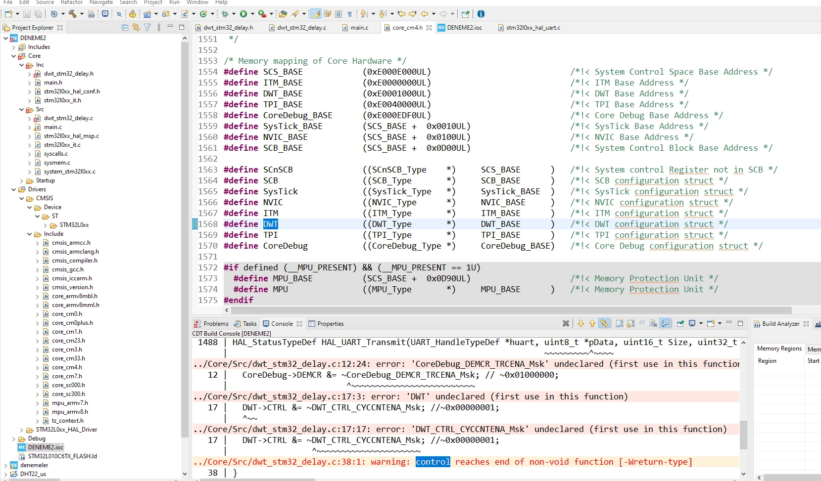

The STM32L010C6TX use a M0+ core not a M4 core. So look at core_cm0plus.h
In M0/M0+ core there is no DWT

this is the header file

You can't. The M0+ doesn't have DWT.
You have to use a timer to do the same thing.
