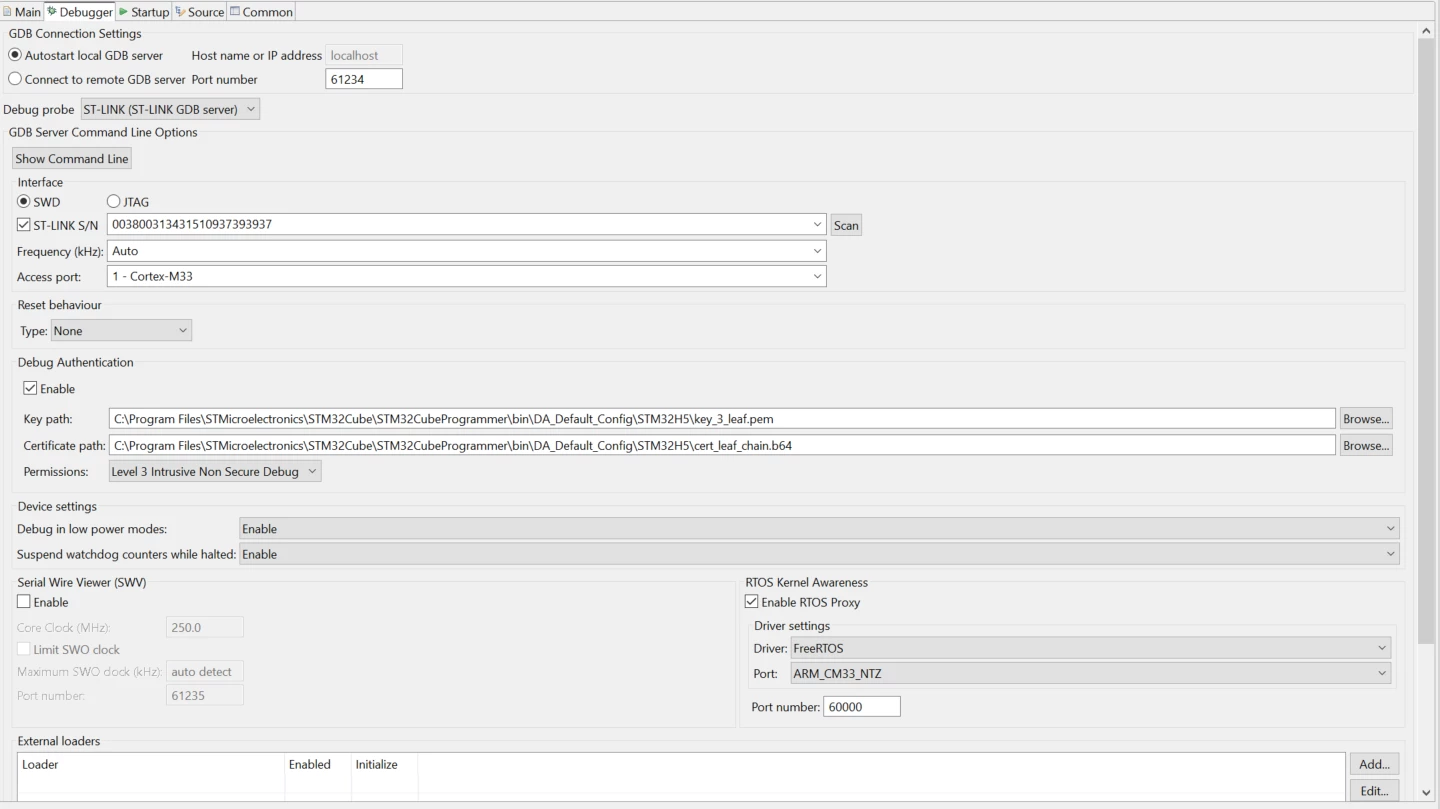

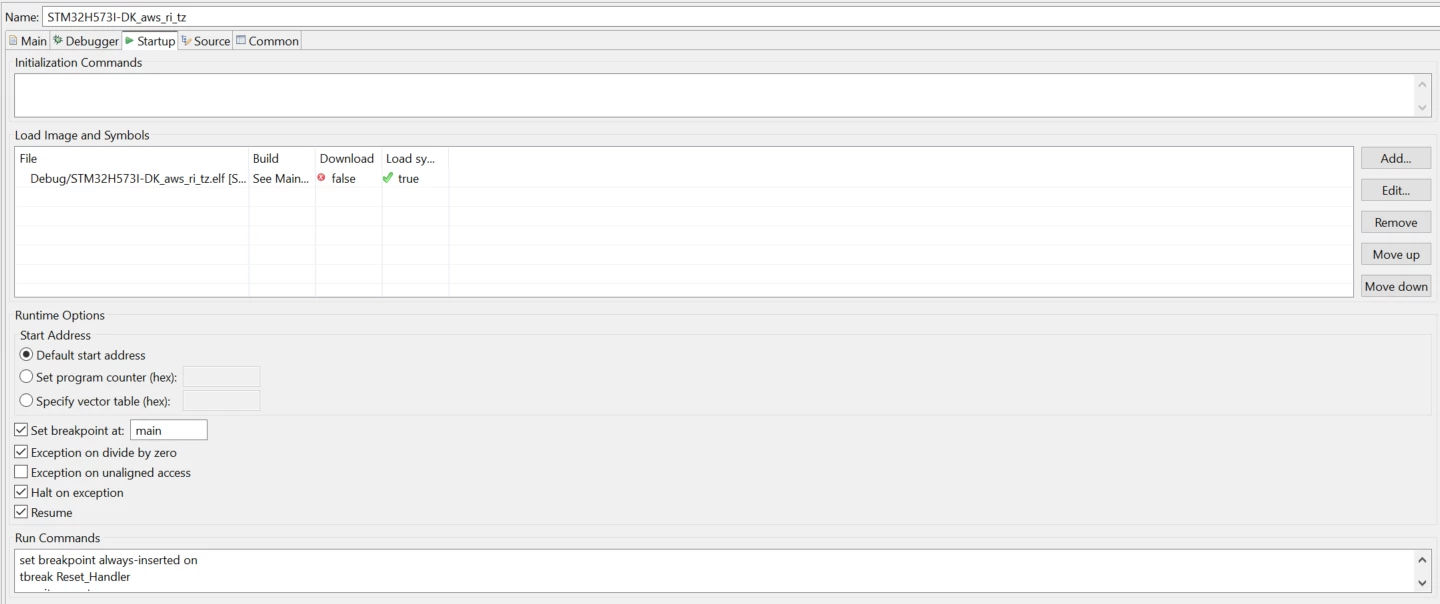

After noticing this error, I tried to check via code what could be happening. Then I realized that it was not possible to debug the code, researching a little I found that you need to put the keys in to enter debug mode, as seen in the video https://www.youtube.com/watch?v=BOBXqUg-PQs, I did the procedure, however, I still cannot enter debug mode, can anyone help me?
Below are the debug configurations used:
Thanks in advance!
