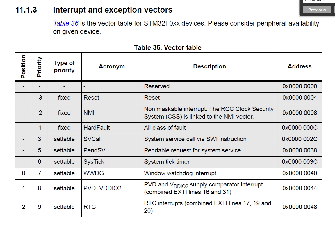

    Going to be expecting the Vector Table to be at 0x08000000, and one of the entries is going to be pointing to the handler.
    Dump the 32-bit words at 0x08000000, and SysTick should be at 0x0800003C as I recall.

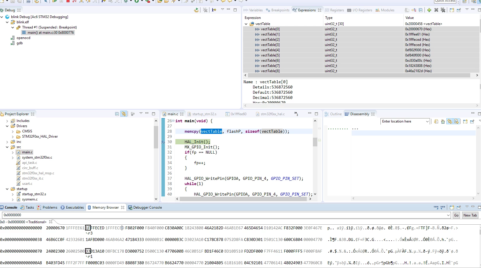

    Radoslav Mar
    Jun 22, 2018 10:16 AM UTC
    Posted on June 22, 2018 at 10:16
    Looking at the Reference Manual I see that the vector table for this chip starts from 0x00000000.
    Then I checked the values of these addresses and saw nothing like 0x0800 ....
    This is the debuggers view of these addresses:
    It seems to me that the the vector table is nit initialized at all.
