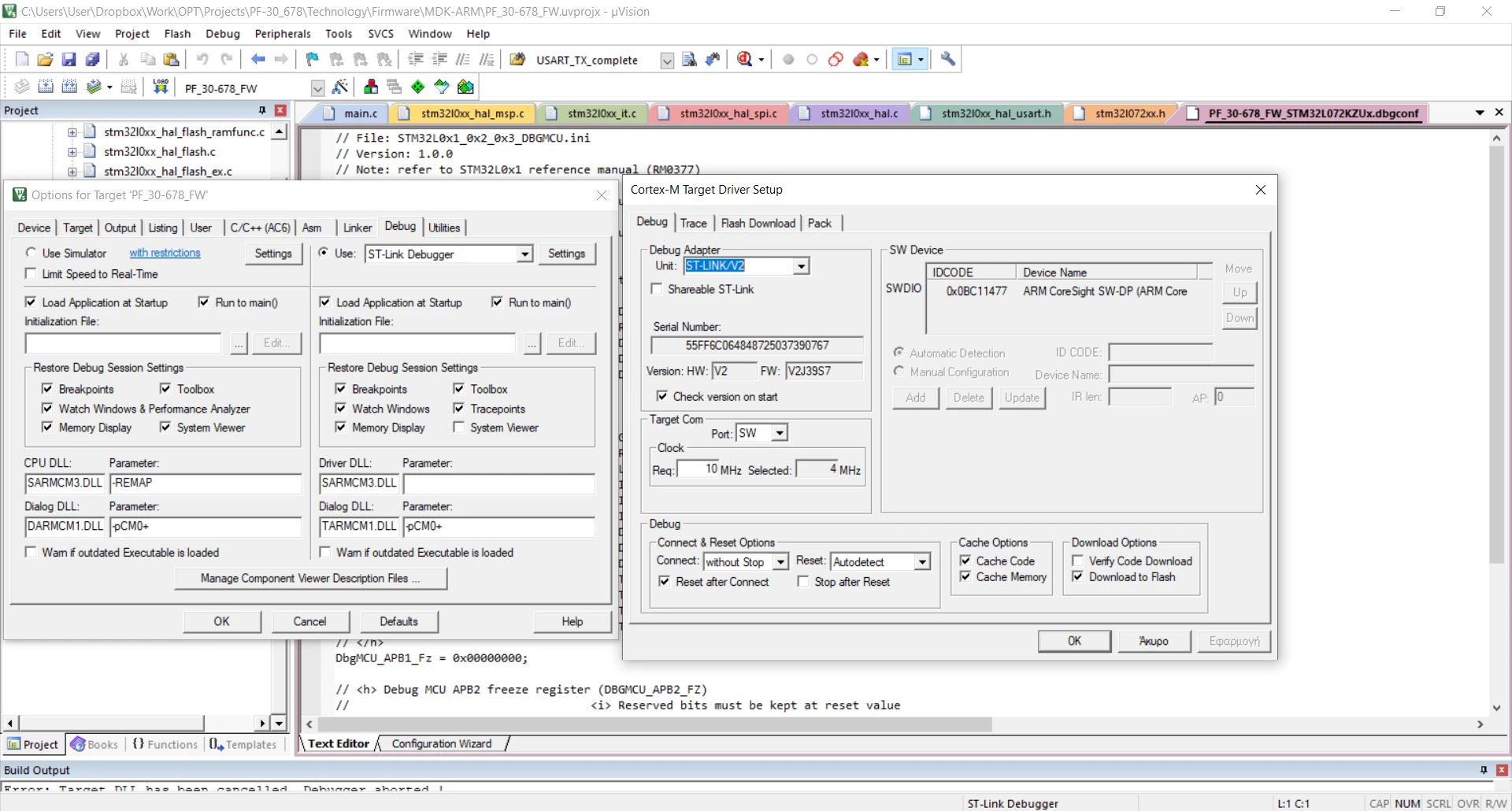

I am rather new to STM32. Ιn my project, I am using an STM32L072KZU6 and I want to debug the firmware using the ST-LINK/V2-ISOL. I connected both SWDIO and SWDCLK pins to pins 7 and 9 of the ST-LINK/V2-ISOL, along with +3.3 V on pin 1 and ground on pin 4. (Pin 2 is connected to +3.3 V, too.)

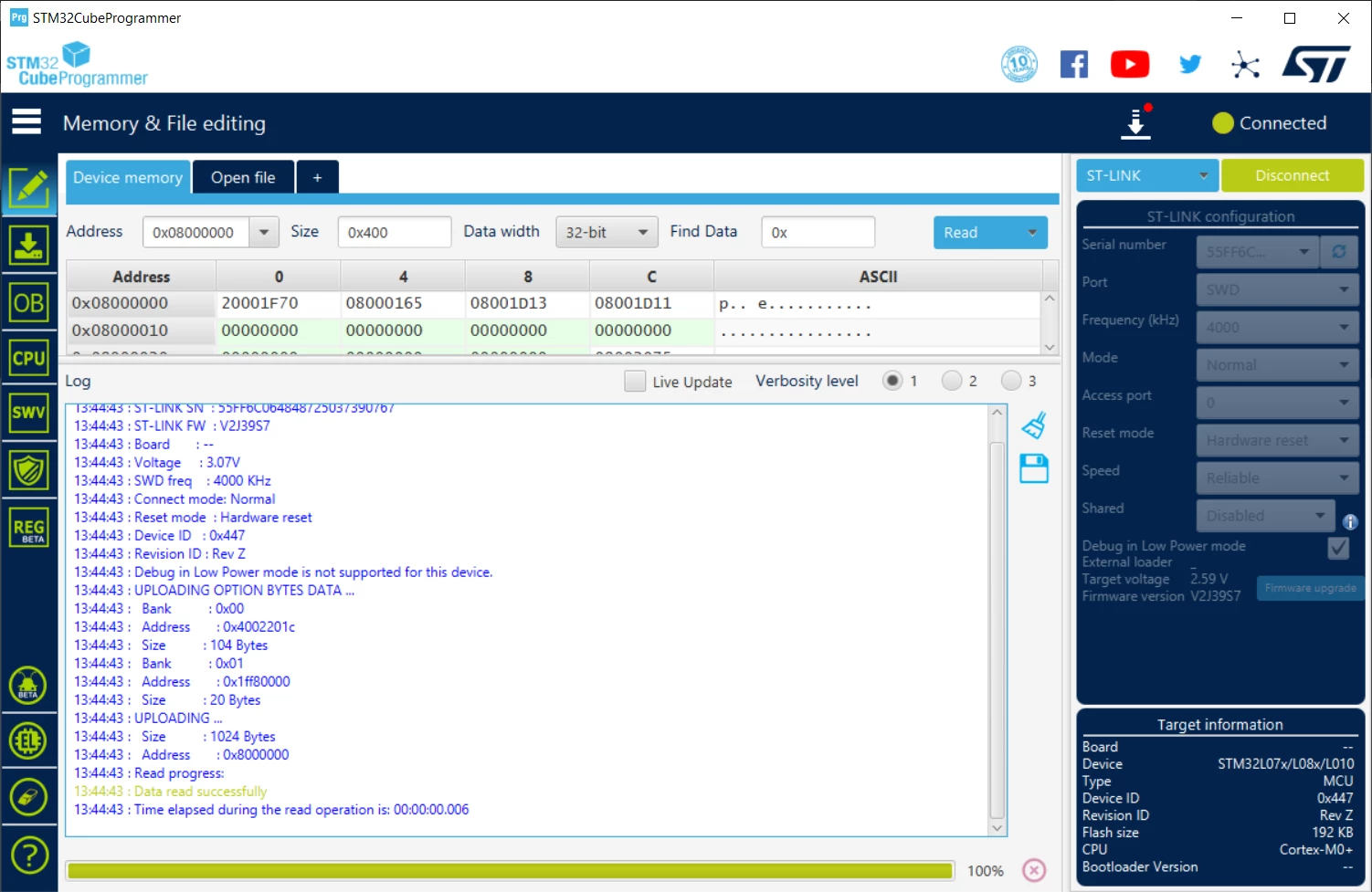

In ST32CubeProgrammer, I can connect to the target MCU without problems:

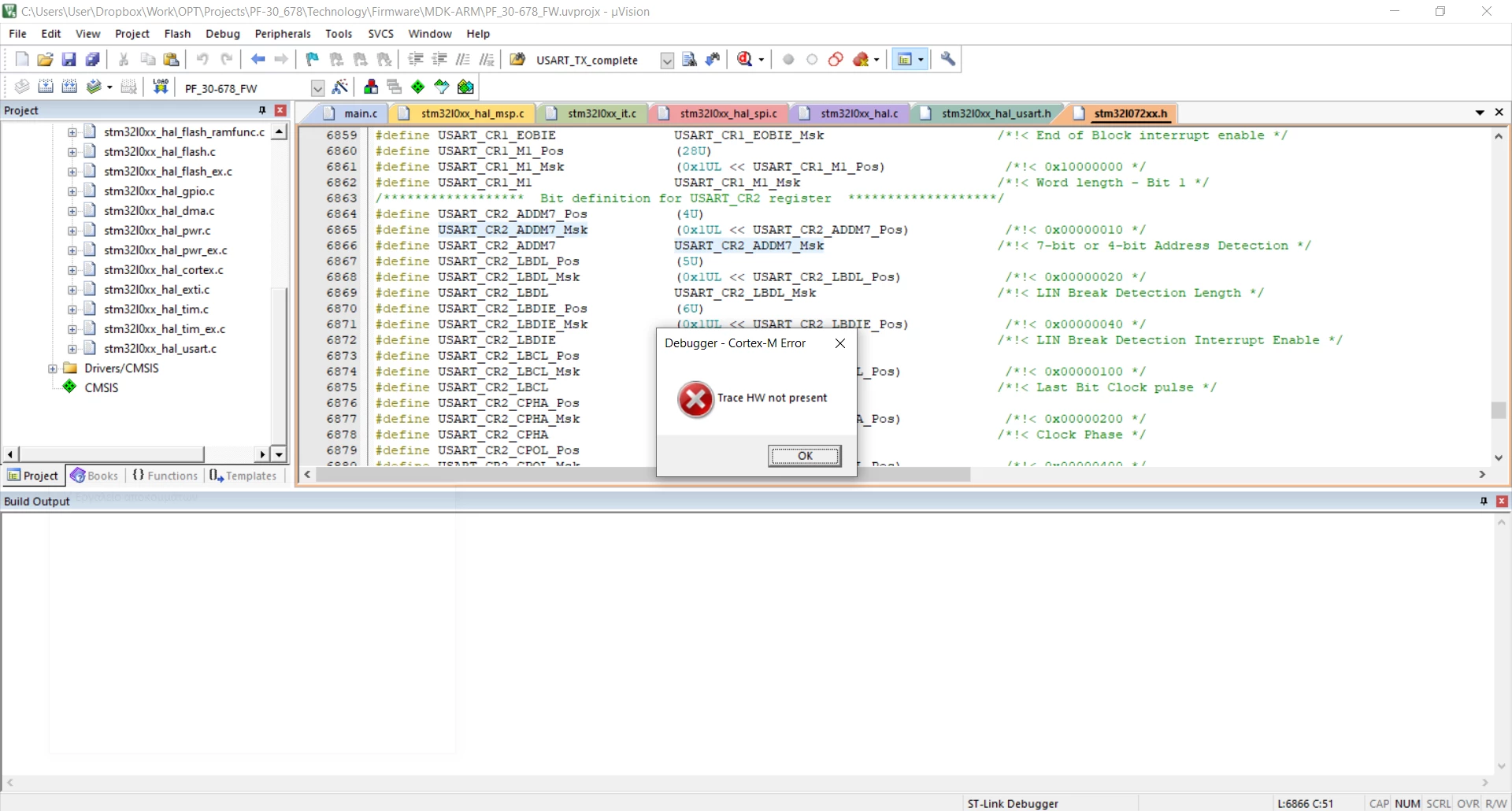

0693W00000aINKGQA4.pngHowever, when I try to use Keil uVision v5.37.0.0 and click on Start/Stop Debugging Session, I get a dialog box with the message "Trace HW not present":

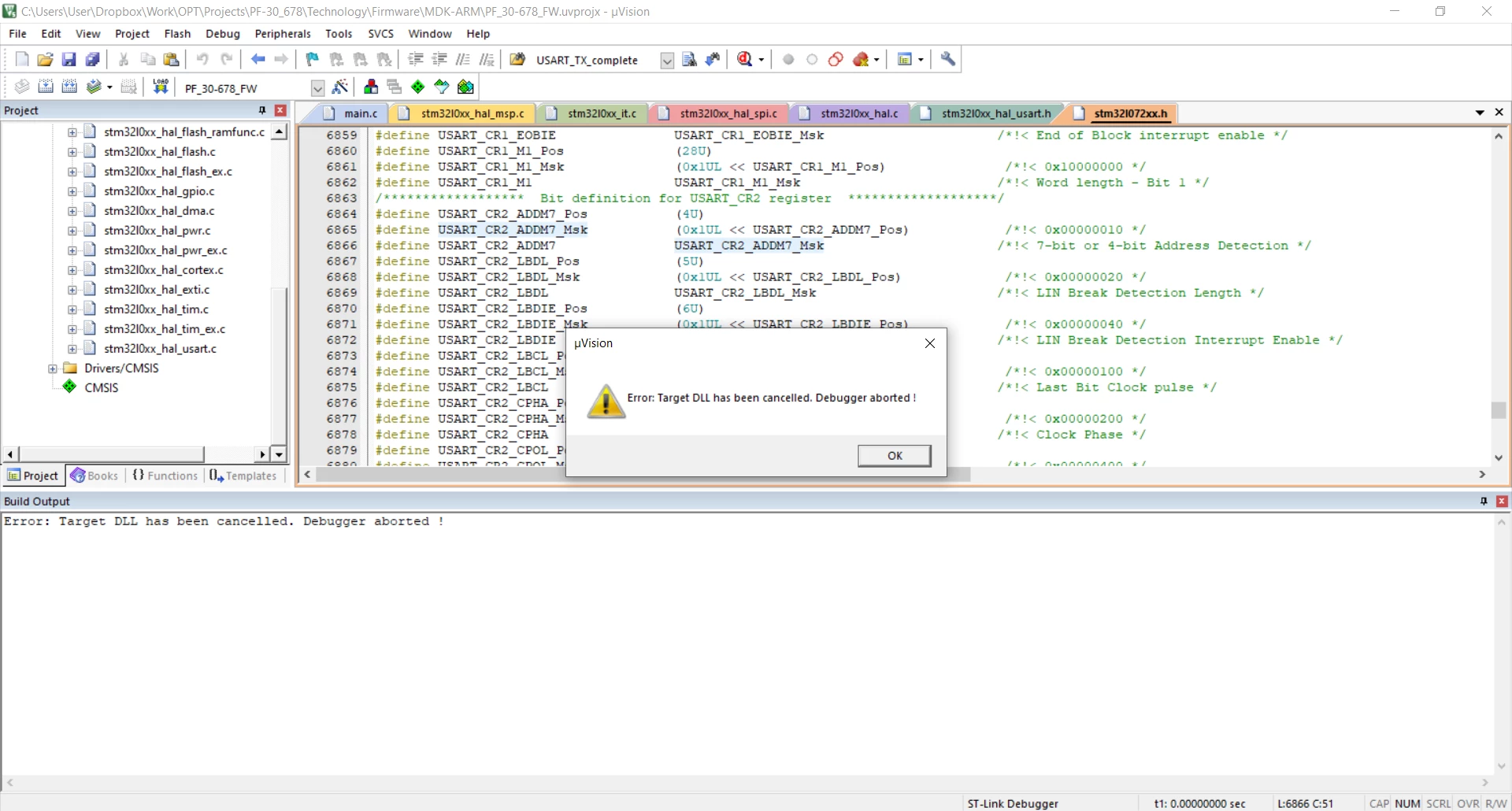

0693W00000aINO1QAO.pngand, when clicking on OK button, another dialog box appears with the message "Error: Target DLL has been cancelled. Debugger aborted!":

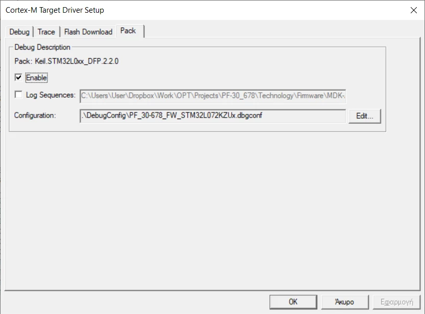

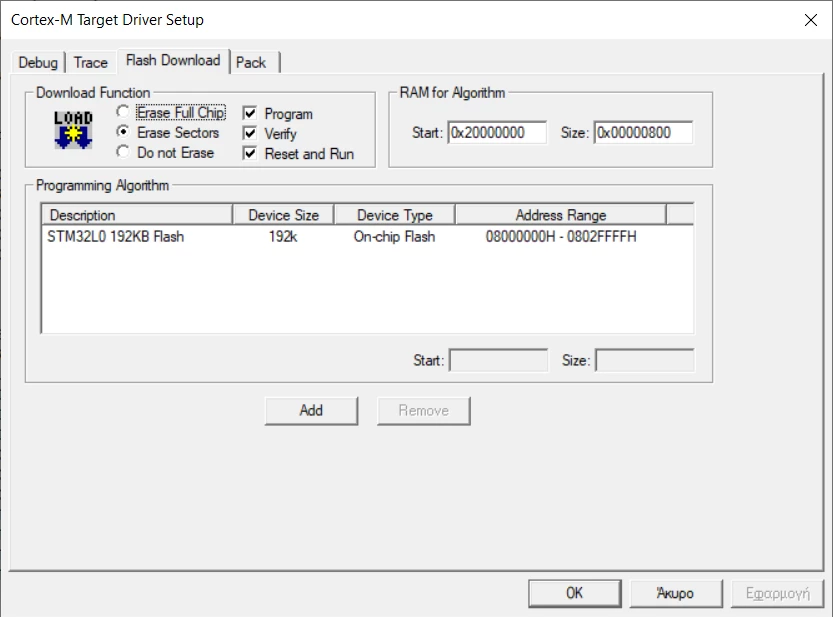

Here are the settings for ST-LINK debugger in Keil:
0693W00000aINQHQA4.png0693W00000aINQbQAO.png0693W00000aINR0QAO.png0693W00000aINRAQA4.png

The CM0(+) does not support ITM trace, uncheck the enable box in the trace settings.​

@Community member​, that worked for me. Thank you!
