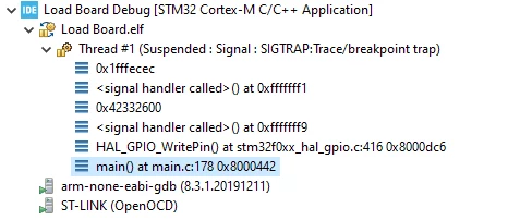

Debug randomly causes "Signal Thread #1 (Suspended : Signal : SIGTRAP:Trace/breakpoint trap)"
I'm trying to write a piece of code using STM32 Cube IDE but when trying to debug i get the following error and i really cant get rid of it.
   0x1fffecec
   <signal handler called>() at 0xfffffff1
   0x42332600
   <signal handler called>() at 0xfffffff9
   HAL_GPIO_WritePin() at stm32f0xx_hal_gpio.c:416 0x8000dc6
   main() at main.c:178 0x8000442
Tried on two different computers, trimmed the code to a few GPIO writes, disabled most pins/peripherals, changed Flash Wait States, nothing solves the issue yet.

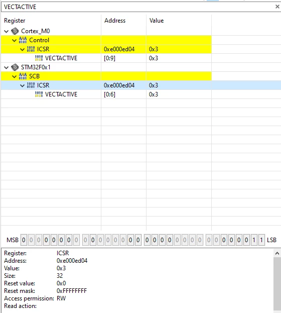

Hard to know exactly. It could be that your vector table is corrupt/invalid and it's trying to jump to an invalid address (0x42332600). You can look at the VECTACTIVE bits to see what interrupt the chip is in and go from there.
SLe B.1
SLe B.1Author
Oct 13, 2021 1:21 PM UTC
Thanks,
VectActive = 3
Oct 13, 2021 1:32 PM UTC
Subtract 16 and look up in IRQn_Type. That one is HardFault_IRQn, probably because 0x42332600 is an invalid address. You need to figure out why it wants to jump there.
SLe B.1
SLe B.1Author
Oct 13, 2021 2:02 PM UTC
Substract 16 in PC ? ICSR Addres ?

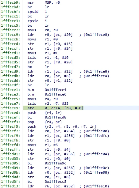

The 0x1fffecec is here
I can't find IRQn_Type within the regular SFR how can i do ?
Oct 13, 2021 2:10 PM UTC
Per your screenshot, VECTACTIVE = 3.
Subtract 16 and you get -13.
Look up IRQn_Type in the software and you'll see values like this (different on the F0, but similar):

-13 corresponds to HardFault_IRQn, so the processor is in the hard fault interrupt.
Because the processor is going to 0x1fffecec for this interrupt and not to somewhere in your program, it suggests your vector table is missing or corrupted or something else.
