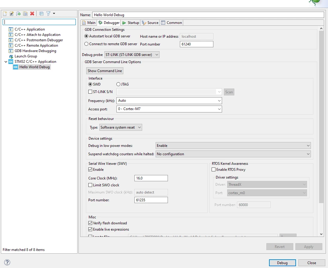

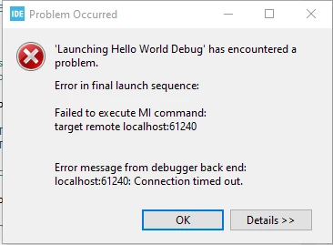

Hi, I have a problem where I cannot debug my code bcs of this error. Anyone know how to solve these problem?
btw im using the STM32H750VBT6x for MCU and ST-LINK V2

This often means that the debugger cannot fit the program into the target memory.
 STM32H750 has only 128 of internal flash. Is your program too big?

No, Im just try to debug the simple basic program like "Hello World" using serial debug only. So, what is possible mistake that I have make?

Check the link script, are the memory regions defined correctly? Is the initial stack address correct?
