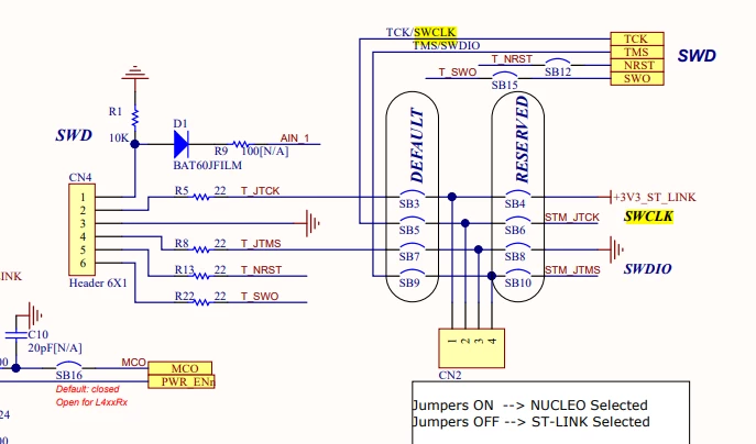

in case of the usage of the microcontroller win one of our development boards this is being handling via the embedded STlink which is another microcontroller connected to the debug pins here is a snippet of the schematics for NUCLEO-L053R8 for reference :
The hardware you are using to initiate a debug session and the way you are doing it is quite unknown for me, and, after checking there is no identified problems with debug interface for this microcontroller.

Thanks to advice me with a detail of the MB1136 mother board. This detail show how the SWDIO and SWCL are tied to PA13 and PA14 of the MCU for debug.
I am connected directly on PA13 and PA14, with jumpers on CN2 out.
I'm enjoyed the debugger runs well with ST-LINK and ST Softwares Partners Packages. Then my question in short is do you provide timing diagrams of this interface, as you describe it in RM0367 page 954.
My hardware connected to the MCU's pin, doesn't get any ACK signal from the MCU. En exemple of timing chart could allow to check if bit transferts are right tuned?
