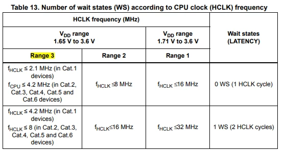

Amel NASRI
Jan 6, 2025 2:58 PM UTC
Hi @MVeen.1 ,
Please make sure to be aligned with the maximum CPU frequency allowed for Range 3 (as explained in this table):
-Amel
