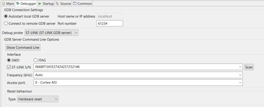

I am using ST-LINK/V2 (STM32 Nucleo-64) to debug a custom board, which the custom board use STM32F105VC MCU.
The HW connections are as follow:
SWD, Custom Board
  1. 3.3V, 3.3V
  2. SWCLK, PA14
  3. GND, GND
  4. SWDIO, PA13
  5. NRST, PB4 (NJTRST)
  6. SWO, Not use
Maybe E1 (NRST) should be select in stedet for NJTRST ?
Is it correct to connect BOOT0 to GND through a 100k ohm?
Please, take a look at "Debug Configuration", "NRST", "JNTRST" pictures.
Error:
STM32_AppReset(), failure reset target
Someone can explain to me, what am I doing wrong?
Thank you.

Aug 9, 2021 10:25 AM UTC
BOOT0 pulled low is good.
NRST should be the processor NRESET, not that of the JTAG.​

Aug 9, 2021 11:41 AM UTC
Thank you Tesla DeLorean,
I am using NRST now and I get following error:
Waiting for debugger connection...
Debugger connected
Target is not responding, retrying...

Aug 9, 2021 1:10 PM UTC
What is IC1?
NRST should have a 0.1uF cap and be pulled up (or left floating). It can be driven by an open drain output but shouldn't be driven high.
Also note that the STM32 has an internal BOR and POR circuitry and an external power supervisor is not necessary.

Aug 9, 2021 1:14 PM UTC
IC1 "STM1815T" is low power reset circuit.
Aug 9, 2021 1:32 PM UTC
Don't use a push pull output to drive NRST. This prevents other things from resetting the processor.

Aug 9, 2021 1:48 PM UTC
Thank you TDK,
Maybe it is good to have the IC, if my input voltage is below 3.3V then it resets the MCU. But now, I have connected NRST pin directly to the ST-link/V2 NRST pin, and the debugger issue related to reset fail has been not appeared any more. Instead I get following error:
Error: No STM32 target found!
Encountered Error when opening C:\ST\STM32CubeIDE_1.4.0\STM32CubeIDE\plugins\com.st.stm32cube.ide.mcu.externaltools.cubeprogrammer.win32_2.0.0.202105311346\tools\bin\STM32_Programmer_CLI.exe
Error in STM32CubeProgrammer
Debugger connection lost.
Shutting down...
Do you think, the above issue still is related to reset pin?

TDKBest answer
Aug 9, 2021 2:16 PM UTC
A supervisor is fine to have it if you want, but it needs to be an open-drain output to allow other things to reset the chip when necessary, like the debugger and things internal to the chip. Your IC has push-pull output.
I'm assuming you fixed the error and connect the NRST pin on the SWD connector to the NRST pin on the chip. You'll also need to remove the IC1 and R3. Have you done all three of those things? NRST should also have a 0.1uF capacitor on it, but I don't think that will cause this issue.
If so, and it still doesn't work, not sure what it could be. Perhaps another schematic error or a soldering error.

Aug 11, 2021 9:02 AM UTC
Thank you for your help TDK,
I am able to debug the MCU after I removed IC1 and R3.
