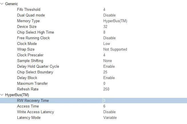

AAree.1
AAree.1Author
Apr 3, 2023 11:26 PM UTC
Thank you for answering me.
I am using the STM32H735 discovery, the problem is that the data I am reading is not the same written, it's like the data is totally corrupted. I have generated the code with STM32CUBEMX.

Apr 4, 2023 6:07 AM UTC
I'm using the same board, works like a charm, memory-mapped mode.
Make sure that it's not running at more than 100 MHz.
Here's my almost non-HAL setup:

Apr 5, 2023 12:56 PM UTC
Hello @AAree.1​,
Unfortunately I can not specify the root cause of the issue, but I will try to provide general recommendations that might help :
  • Please ensure that all the instructions of data cache are disabled and check if the problem persists.
  • Please make sure you are respecting the timings of the memory's datasheet.
  • Please check the configuration of the OCTOSPIM if used.
  • Try working with low frequencies and check if the problem persists.
  • When generating the code with STM32CubeMX please check the alternate functions generated.
