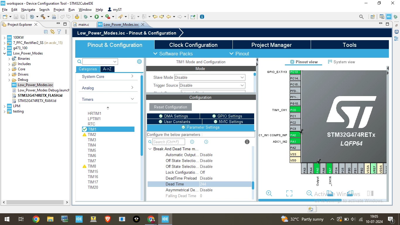

hi I'm using NUCLEOG4 series controller. configuring TIM1 in both normal and complimentary PWM. PWM is generating, no problem in that. but i want 24 micro seconds of dead time between top and bottom pwm. but i can able to achieve maximum of 6 micro seconds only. As per the datasheet and calculation, dead time insertion value for 24 micro seconds is 244, but output dead time is maximum 6 micro seconds.
can anyone suggest how to achieve 24 us deadtime in nucleog4 and I'm running at 170MHZ.

nucleog4 stm32g474ret6 controller at 170MHZ
I'm just directly keeping the calculated 244 value in deadtime configuration section in IOC file.

That's not the full ioc file, just a screenshot of a single value.
From what I read in RM0440 the dead time value is a 10 bits value, so it should work from 0 to 1023. So 244 ticks should work.
DTG is 3 bits and has 4 possible values: 1,2,8,16 * DTS
Can you post the register values?
Can you post an oscilloscope/logic analyzer capture? Pick a sane duty cycle. Use several values for dead time.

I think I figured it out. I didn't know anything about this particular MCU or how these timers worked, but after reading the reference manual (RM0440) I think I found it:
from RM0440 Rev 8:
"Bits 9:8 CKD[1:0]: Clock division
This bitfield indicates the division ratio between the timer clock (tim_ker_ck) frequency and
the dead-time and sampling clock (tDTS )used by the dead-time generators and the digital
filters (tim_etr_in, tim_tix)"
looking at the block diagram you will see tim_ker_ck, tim_psc_ck and tim_cnt_ck
The prescaler divides tim_psc_ck and outputs tim_cnt_ck, but the dead time uses tim_ker_ck.
You generally want tiny dead time values, even with high prescaler values, so it makes sense the dead time block is clocked separately. So set Internal Clock Division in STM32CubeMX.
