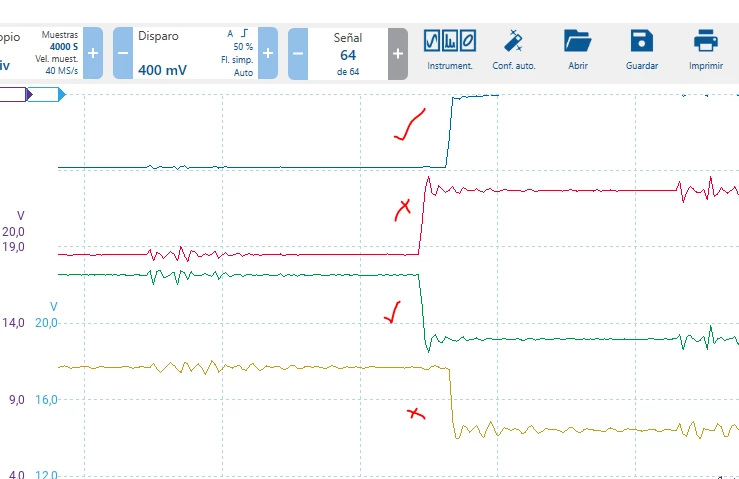

Dear team,
I am using a STM32G474 in my application. I've generated a PWM in the HRTIM TIMER E that is active low (necessary for the requirements of the modulation). I want to insert a dead band between this signal and its complementary (Output 2). The problem when using this functions
LL_HRTIM_DT_SetRisingValue(HRTIM1, LL_HRTIM_TIMER_F, value_to_set_hv);
LL_HRTIM_DT_SetFallingValue(HRTIM1, LL_HRTIM_TIMER_A, value_to_set_hv);
is that the dead band increase the duty of the signal, so no dead band is inserted, in fact, during this time, the 2 pwm are active (view image). What can i do to solve this problem? I know that one solution is to change the actual pwm output 2 to output 1 and set it to active high, but i rather prefer to avoid this. And i want to only control output 1, i do not want independent signals.

    I understand that you want to apply to deadtime on both edges of Timer E output (active low). Functions below are not applied on the same Timer Unit? is it what you intend?
    Could you please put signal names on waveformes above to help understanding your situation,
    Best regards.
    PMorenoAuthorBest answer
    September 3, 2024
    Thanks for the reply, but i solved this issue. ST has an option to define negative dead bands, this solved my issue.
    Best regards.
