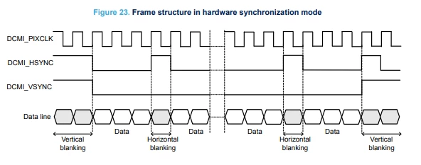

The image sensor had been configured to output a gated pixclk, meaning that its waveform looked like this:
It appears that there's some logic inside of the DCMI peripheral that assumes that pixclk toggles a few times before hsync or vsync become active. After changing the pixel clock from gated to continuous, the DCMI peripheral works as expected. Interrupts work, status bits are correct, and the cropping function works!

What do you mean by "changing the pixel clock from gated to continuous"?
The DCMI is a slave and doesn't stat work only if DCMI_VSYNC and DCMI_HSYNC signals are coming.
Also as shown in AN5020, if the DCMI_PIXCLK start before the DCMI_VSYNCH and DCMI_HSYNCK the DATA are blanking.
