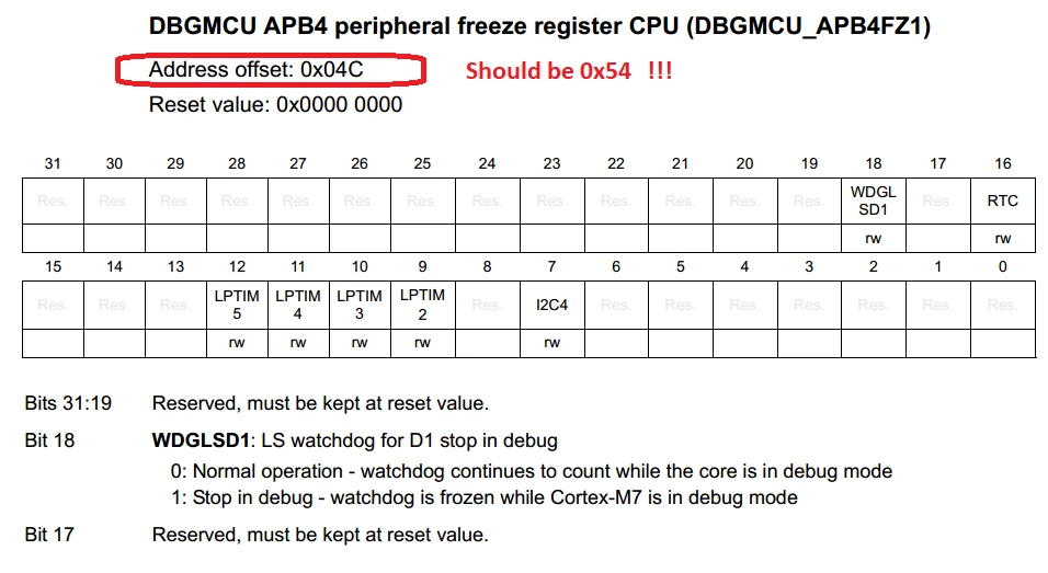

DBGMCU in RM0433 has wrong offset for DBGMCU_APB4FZ1.
In the RM0433 (rev 3) the DBGMCU_APB4FZ1 offset is incorrectly marked in the detail section.
It is 0x04C and should be 0x054.
The register summary is correct. But if somebody is using the detail section - can make an error.
BTW: What does the LS stand for in WDGLSD1 (related to other question I posted)?

You should pull Rev 4 it is fixed in that.
I think LS in this context means it is in the Low Speed domain
