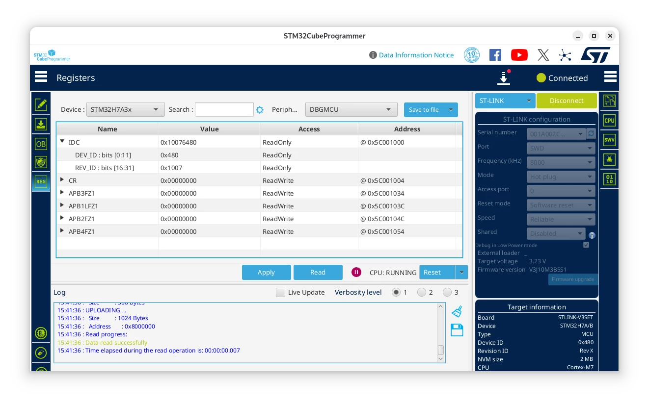

We have been trying to access DBGMCU on an STM32H7A3 via software. The background is that the project shares code that in an other project runs on an H743 and for example needs to adjust how it interacts with the flash.
We’re now experiencing the strange behaviour that when a debugger is connected the DBGMCU ID code reads correctly as 0x10076480. When no debugger is connected it reads as zero (0x00000000). This is the case when debugging using GBD or when connecting via STM32CubeProgrammer. Connecting via STM32CubeProgrammer to an already running processor makes it readable. After disconnecting it reads zero again.
We’ve tried accessing the ID both via
AL_GetDEVID()
HAL_GetREVID()
as well as directly via
DBGMCU->IDCODE
with the same results.
Testing access to the writable parts of DBGMCU show a similar behavior where it works when connected to the debugger but not otherwise.
Now we are wondering if there are any clock or power configurations that could lead to such a behavior. We’ve seen similar topics for other MCUs where enabling Debug Module RCC peripheral clock was the solution but we can’t find mention of such a clock in the Reference manual for the H7A3.

MatthiasJ
MatthiasJAuthor
Sep 2, 2026 2:12 PM UTC
Hello ​@KDJEM.1,
Since direct debugging isn’t an option we are using a JSON via USB serial interface to read out the information. Please see below screenshots of the code used to test, the output collected from it and a screenshot of the STM32CubeProgrammer when connected and displaying the correct values. Note that Mode = Hot plug to enable connecting and disconnecting the STM32CubeProgrammer during a single run making it clear that the same code during the same run behaves differently depending on the STM32CubeProgrammer being connected or not.
For clarity please note that the tests described run inside our full firmware, not a minimal project. The main reason for this is that the behavior is influenced by debugging so any test environment would have to at least implement one of our serial drivers to get data out. If necessary we can prepare a minimal project to further investigate this but it will at the very least need to contain some serial driver code.
It is quite possible that there is a difference in what peripheral clock domains are active compared to a bare STMcubeIDE project. Is there any documentation on clock domains that are automatically activated when debugging or are needed by DBGMCU?
Test Code:

Screenshot of STM32CubeProgrammer when connected:

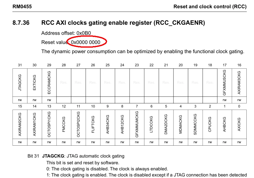

waclawek.jan
Sep 3, 2026 8:36 AM UTC
​@Mike_ST ,
But why?
My copy of RM0455 says, this bit is zero by default.
Mike_ST
Sep 3, 2026 9:31 AM UTC
Hello Jan,
It’s actually 0,
if generating code from MX, in SystemClock_Config, it adds a line like :
  /*AXI clock gating */
  RCC->CKGAENR = 0xE003FFFF;
waclawek.jan
Sep 3, 2026 9:40 AM UTC
Hi Mike,
OK thanks, that explains it.
Surprising nonetheless…
Jan

Sep 3, 2026 8:42 AM UTC
​@Mike_ST
Also, the thread you’re linking to above is specific to STM32H743 - however, there’s no  RCC_CKGAENR register in the related RM0433!
Can you please comment that, too, or maybe better, reopen given thread and discuss this particular issue there.
waclawek.jan
Sep 3, 2026 8:46 AM UTC
​@Mike_ST ,
I’ve looked also at RM0477… and it has a RCC_CKGDISR register, with bits which appear to be inverted to  RCC_CKGAENR registers’ bits in RM0455… and a default which means JTAG clock gating is disabled, i.e. JTAG is always available.
IMO this mess deserves at least a KB article summing up IDCODE availability and gotchas in various STM32 families/subfamilies/models.
