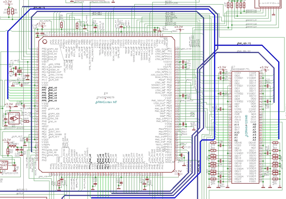

I have an STM32F746 in an own PCB design. A 128 Mb DRAM IS42S32400F is connected to the FMC pins, similar as on the STM32F746G-DISCO board. I can write and read data but there are errors which occur in a systematic way:

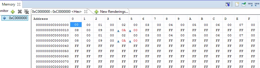

I start writing 16 bit data at address 0xC000 0000.
Data is stored at the the correct address. But, the strange thing is that the same data appears simultaneously at a second location either 32 byte above or below the intended address. How can this happen? How can data be stored at two locations with one write command?
A memory dump screenshot is attached.
I have double-checked all connections and fiddled with timing - but no success.

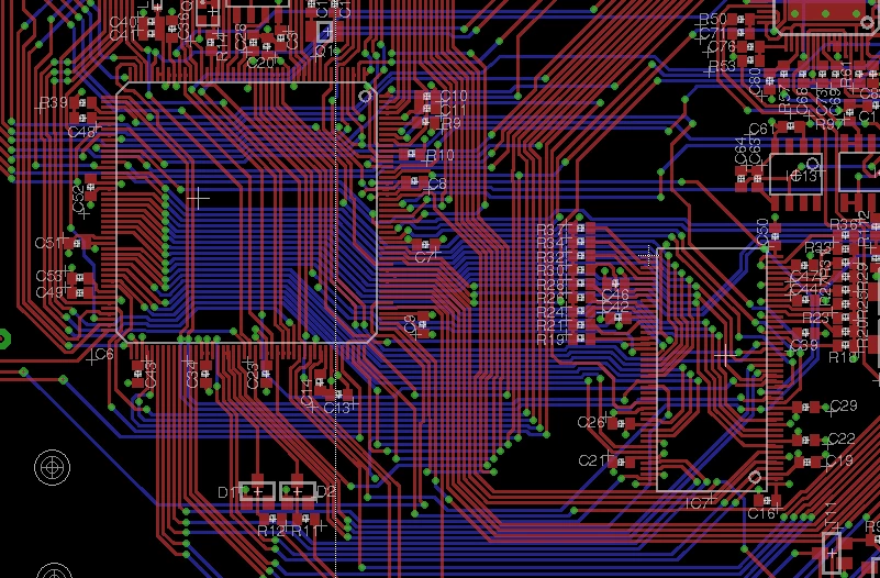

In my design I didn't care about matched trace lengths. Controller and SDRAM are about 4 cm apart. Could this be a reason?
I can also observe the same problem on an LCD sreen since the SDRAM is also my frame buffer.
    One of the address pins is screwed up, ie stuck at one/zero, not connected, not configured, etc.
    Turn off caching while testing.

    I checked again the connections and the signals on the 12 address lines. All of them look normal. The error also happens in the same way if I use an other memory section.
    Turning off the cache did not change anything.
    I agree with you that there must be some logical reason (no timing or signal delay problem) since the error is absolutely reproducible. It even looks the same at 50 or 100 MHz clock.
    Data is written at 3 locations simultaneously: at the intended address, 20h above or below and 2000h above. But may be I'm wrong and it is written correctly and read wrongly?

    It is more probably read back wrongly.
    Rather than hope someone turns up with the same chip and configuration, perhaps post the pin/peripheral initialization code, and circuit specifics, for review.
    Presumably the DISCO works fine with equivalent configuration.

    I have also attached the relevant parts of schematic and PCB.

    As a fundamental, trace length matching is critical to correct SDRAM operation.  The same is true of any high-speed, multi-signal bus (OSPI, QSPI, etc.).
