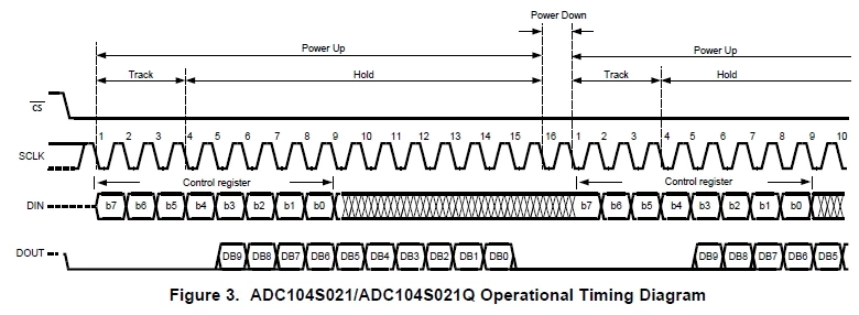

Hi All,
I am developing driver for ADC104S021 for STM32F103
I have tried to read AD converted value from ADC via SPI, the value seemed not correct one.
timing diagram as follows (from datasheet).
my SPI configuration and read function are as follows

MCU_A1_Pin and MCU_A0_Pin are for generating nCS signal, and they are OK.
controlReg variable is for selecting input channel.
I have called HAL_SPI_TransmitReceive() API, since writing control register is overlapped with reading ADC data.

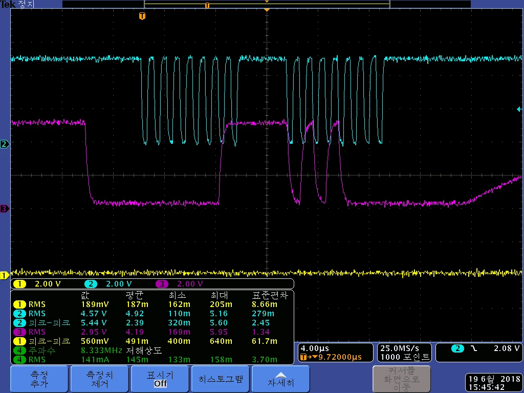

captured data from oscilloscope as follows.
As I read value from capture, it seems to be 0x2, 0x50, but printed log showed it as 0x2, 0xF9.
this is just example, all the values I've got from log are not matched with measured value from scope.
Trying test with multiple ADC values, first byte seems OK, but second byte is totally wrong.

Hi All,
Sorry for confusing.
It was caused by capacitor connected with DOUT pin, data is correctly received after removing capacitor.
