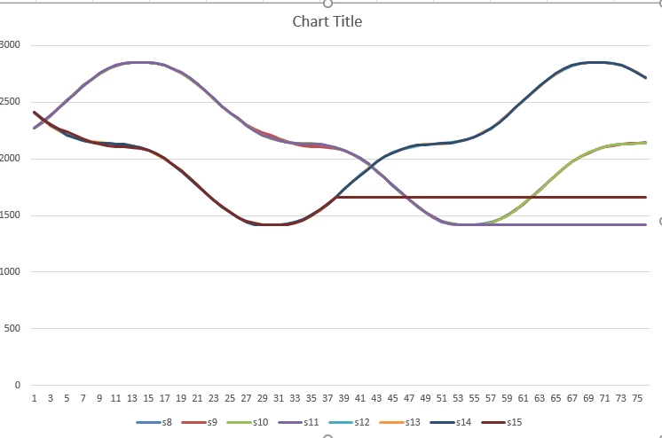

The data being read on ADC is a sine wave of 100Hz. An interrupt is configured to trigger every 10ms where address pointer of the present memory location being filed is stored. NDTR value is read and subtracted from max value of 4082; depending on which memory (0 or 1) is being used the address pointer is stored in a variable, which is used later for processing.
For data cycles where the memory source changes from 0 to 1 or vice versa, the data is ignored.
I did a dump of the memory and plotted the data using address pointers stored. The sine waves looks consistent until a change of memory source happens and the next cycle is shifted from the previous ones by some number of samples ( As said above the cycle where the changes happens is not used in further processing). I am understanding the shift as some portion of data being missed from initial part of the cycle.
Attached screenshot of the data plotted from the memory dump.

Screen shot of data dump plot.
I have also checked the 10ms interrupt on scope. It is consistently happening at 10ms duration.
