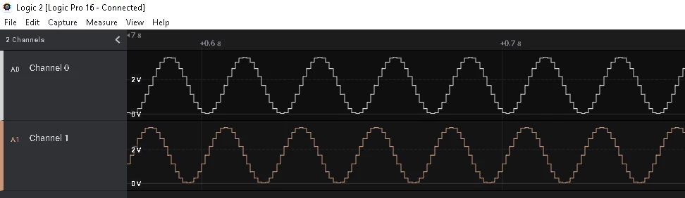

DAC restricted to 0.5volt on a stm32L432 when you add a gpio_output to any PB
  • December 14, 2021
  • 2767 views
DAC restricted to 0.5volt on a stm32L432 when you add a gpio_output to any PB and appears to be the line __HAL_RCC_GPIOB_CLK_ENABLE(); added to MX_GPIO_Init
with
 /* GPIO Ports Clock Enable */
 __HAL_RCC_GPIOA_CLK_ENABLE();
 //__HAL_RCC_GPIOB_CLK_ENABLE();
void MX_GPIO_Init(void)

/* USER CODE BEGIN PFP */
uint32_t wave_time;
uint16_t sinwavevalue ;
uint16_t coswavevalue;
uint16_t sinwave[20] ={2681,3252,3705,3996,4095,3996,3705,3252,2681,2048,1415,844,391,100,0,100,391,844,1415,2048};
uint16_t coswave[20] ={3996,3705,3252,2681,2048,1415,844,391,100,0,100,391,844,1415,2048,2681,3252,3705,3996,4095};
/* USER CODE END PFP */
/* USER CODE BEGIN 0 */
void HAL_TIM_PeriodElapsedCallback(TIM_HandleTypeDef * htim) {
 if (htim -> Instance == TIM15) {
    sinwavevalue=sinwave[wave_time];
    coswavevalue=coswave[wave_time];
     HAL_DAC_SetValue(&hdac1, DAC_CHANNEL_1, DAC_ALIGN_12B_R, sinwavevalue);
     HAL_DAC_Start(&hdac1,DAC_CHANNEL_1);
     HAL_DAC_SetValue(&hdac1, DAC_CHANNEL_2, DAC_ALIGN_12B_R, coswavevalue);
     HAL_DAC_Start(&hdac1,DAC_CHANNEL_2);
     wave_time++;
     if (wave_time==20) wave_time=0;
/* USER CODE END 0 */

What hardware is this, a "known good" board such as Nucleo or Disco, or your own? Do you measure "Channel1" on PA5 or on some other pin? What else is connected to that pin?
Tesla DeLorean
Guru
December 14, 2021
Or anything else on GPIO BANK B.
Check for inter-connnects, shorts. Netlist?
uint32_t wave_time; // global or auto/local ?
