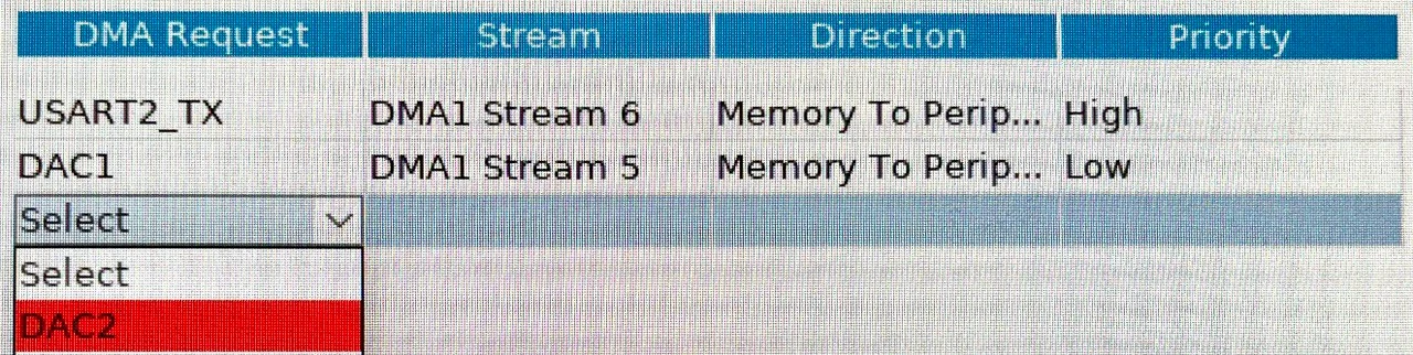

I use STM32F407 Discovery board to generate analog signals using DAC with DMA transfer. The goal is to use both DAC channels to have two signals generated simultaneously. However, I cannot enable the DMA request for the second channel.
After analyzing previous posts, I understood that I need to change the settings on the low level and deal with registers.

i see no problem on F407 :
-> go with mouse to the red marked ... system should tell you, what you doing wrong.

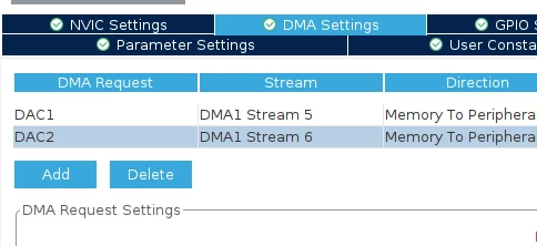

January 11, 2024
Thank you very much! It was conflicting wuth USART... no need to go deep woods :)

January 11, 2024
I just had a short look at the ref manual, to me it seems that you could solve this with 1 DMA channel only, when you choose one of the dual DAC data registers as peripheral target register for the DMA.
