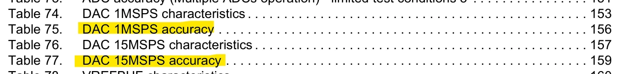

Primarily, the accuracy and temperature drift will depend on your VREF+ accuracy and temperature drift. If you're using the internal VREFBUF, then you can see its performance specification in the datasheet.
Nonlinearity and other accuracy specs can be found in the datasheet:
https://www.st.com/resource/en/datasheet/stm32g474ve.pdf

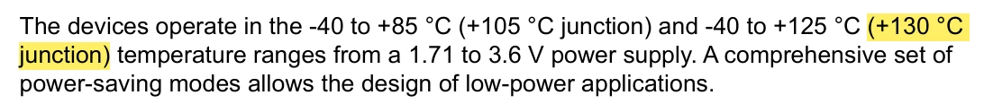

Max junction temperature seems to be 130 C from the datasheet.
