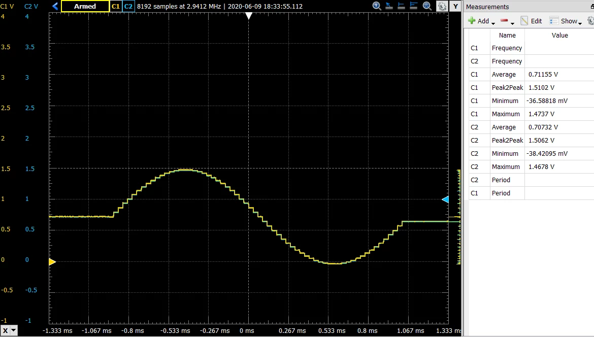

Hi :)

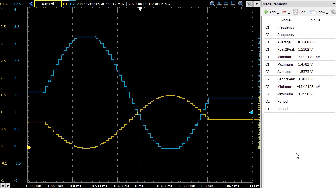

I found something quite strange, it seems that:
1) On DAC Channel 1 - the output buffer does not work (a 10kOhm load brings the voltage down), but it's output is inverted (as expected)
2) On DAC Channel 2 - the output buffer does work (maintains voltage with a 10kOhm load), but it's output is not inverted
My test setup:
  • NucleoF446RE -> PA4/A2 pin -> oscilloscope + 10k resistor (in parallel)
  • NucleoF446RE -> PA5/D13 pin -> oscilloscope + 10k resistor (in parallel)
  • The code runs a simple one-time 500Hz sine wave with samples @32kHz with DMA. I also tested without DMA with a simple HAL_DAC_SetValue() and the result was exactly the same (but not as "visual" as with a sine wave).
The results:
With Output buffer OFF on both channels, the sine wave is not inverted, and the voltage is sinked to max 1.5V - this is as expected.
With the output buffer ON on both channels, you can see that Channel 1 (yellow) is inverted but its output is still sinked, and that Channel 2 (blue) is not inverted but its output is maintained with the load.

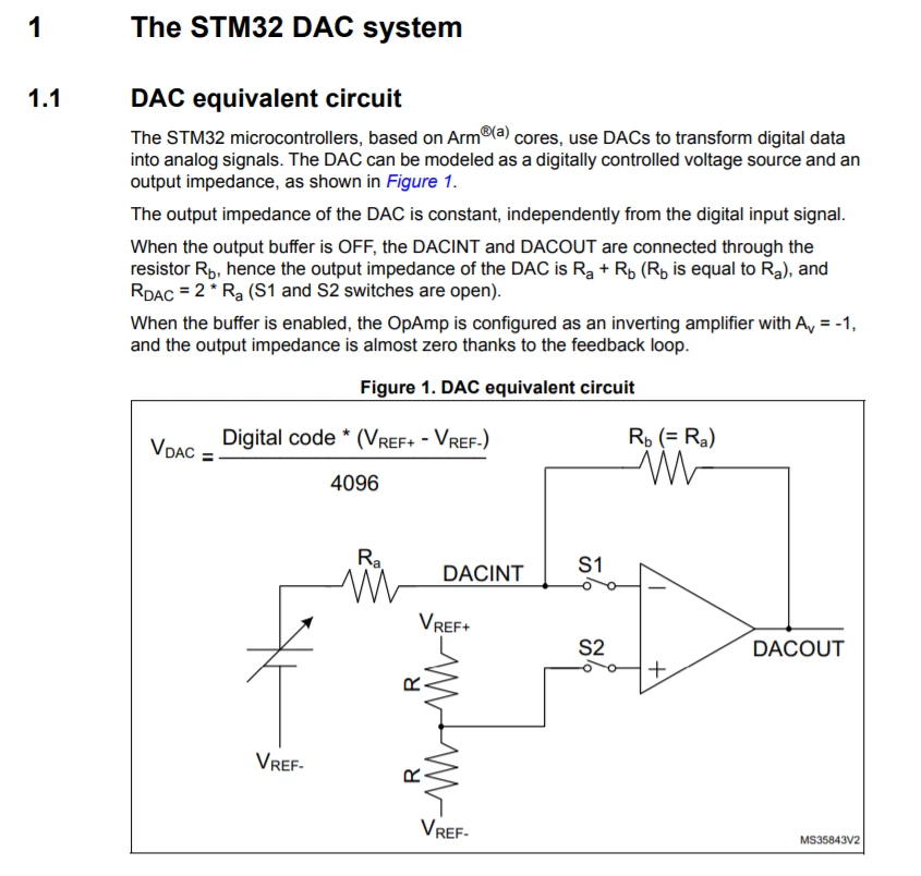

And yes I would expect the buffer to invert the output, since it is configured as an inverting opamp with G=-1 ?
See from https://www.st.com/resource/en/application_note/dm00129215-extending-the-dac-performance-of-stm32-microcontrollers-stmicroelectronics.pdf @page 5:
Interesting. Why wouldn't the RM mention that?

Just FYI - I tested it on my Disco-L1 board and it works as expected: no inversion and the DAC can handle a light load, same on both channels.
