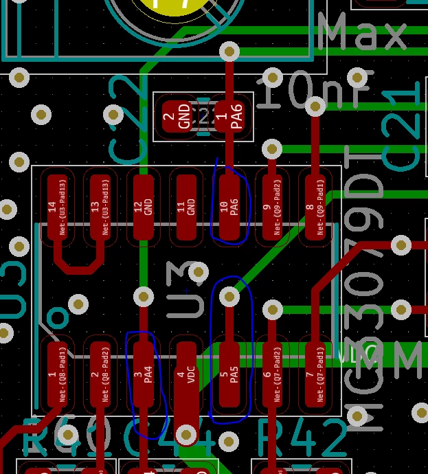

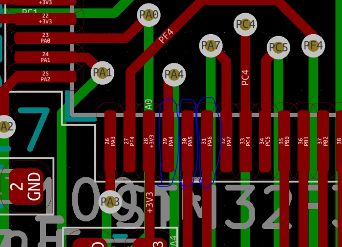

I have a STM32F373VBT and when I enable the DAC output, then I get only 0.06V as output, no matter what DAC value I send to the DAC.. I don't understand why i get only fixed 0.06V as output for both of these DAC outputs.

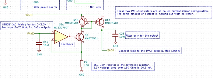

First if all, the DAC outputs are going to drive a OP-amp. This OP-amp will transform 0-3.3V to 0-20mA output by help of 24V voltage source.
0693W00000BcDDXQA3.pngI have connected the DAC pins here to the OP-amp.

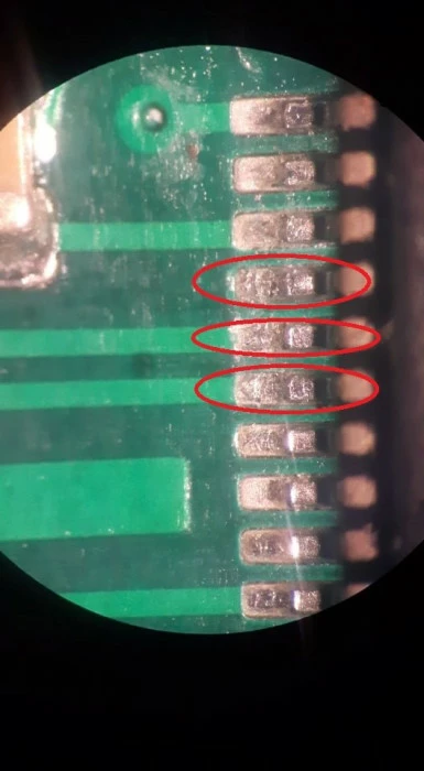

And there are no solder bridge between the MCU's pinns.
Not even them are attached to the GND. I have checked with a DMM.

The opamp is not powered by anything yet. It just there. So the current from the DAC goes directly to the non-inverting inputs of the opamp.
Yes. I'm talking about DC voltage. Measured at the pins of the MCU.
