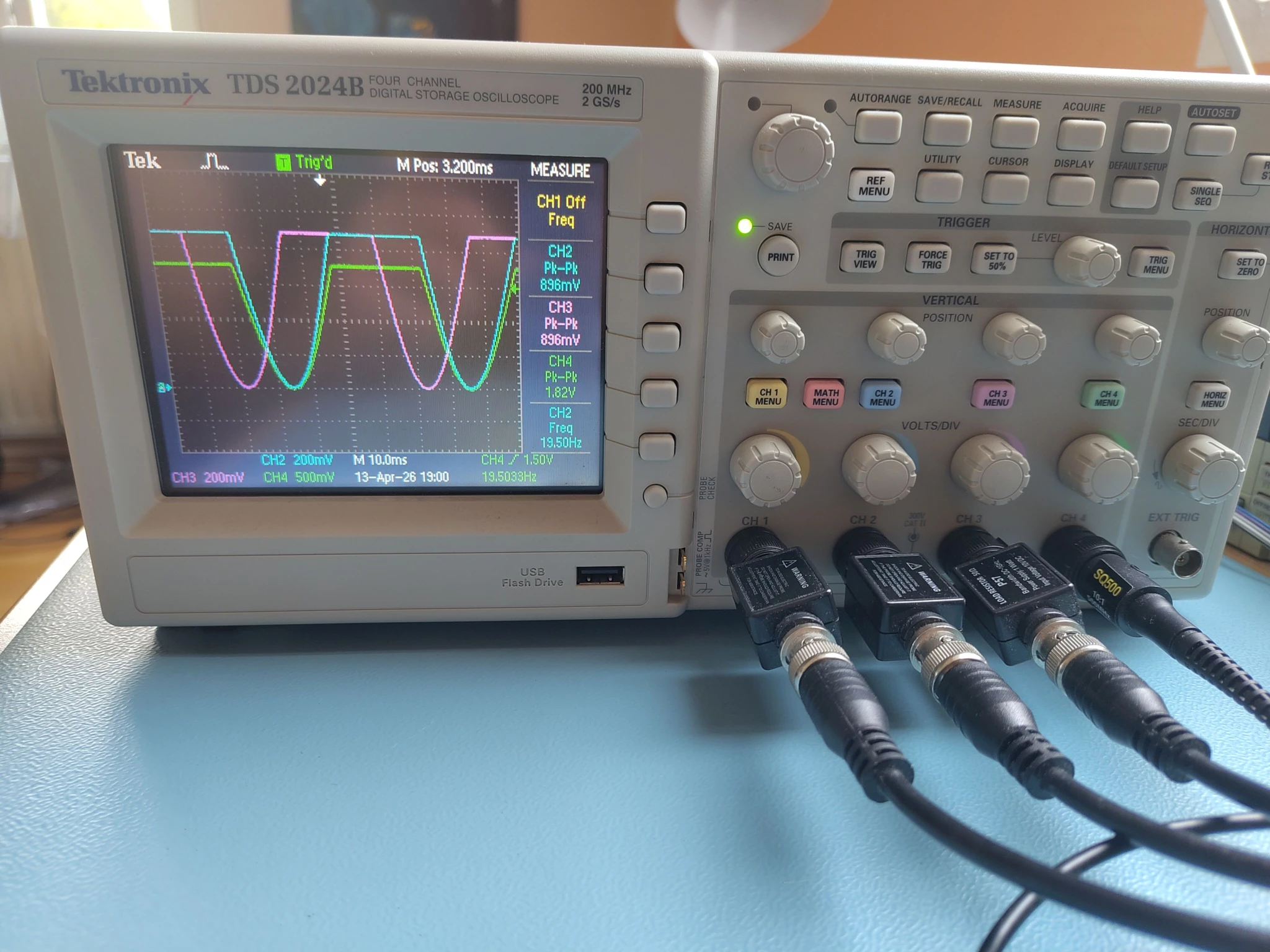

I'm using a STM32F072's DAC to output a SIN and a COS wave. The problem is I can only output values up to approx. VDDA / 2. The DAC drives unity gain amplifiers to drive a 50 Ohm load. The DAC is connected directly to the amps, using the buffer does not help. VDDA = 3.3 V.
Here, CH4 is connected directly to the DAC output via a 10:1 probe. The black things on the scope inputs are 50 Ohm termination, so the CH2 and CH3 signals having only half the amplitude of CH4 is expected. All channels are DC coupled.

LMV342 is not specified to drive 50 Ohm load. DS says 2-10 kOhm

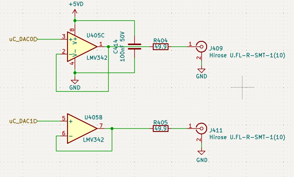

Can you show the circuit for the unity gain amplifiers? I'd measure the voltage upstream of those to eliminate that as the problem. Put out a DC value and verify with multimeter. Or the oscilloscope if convenient.
GChri.2

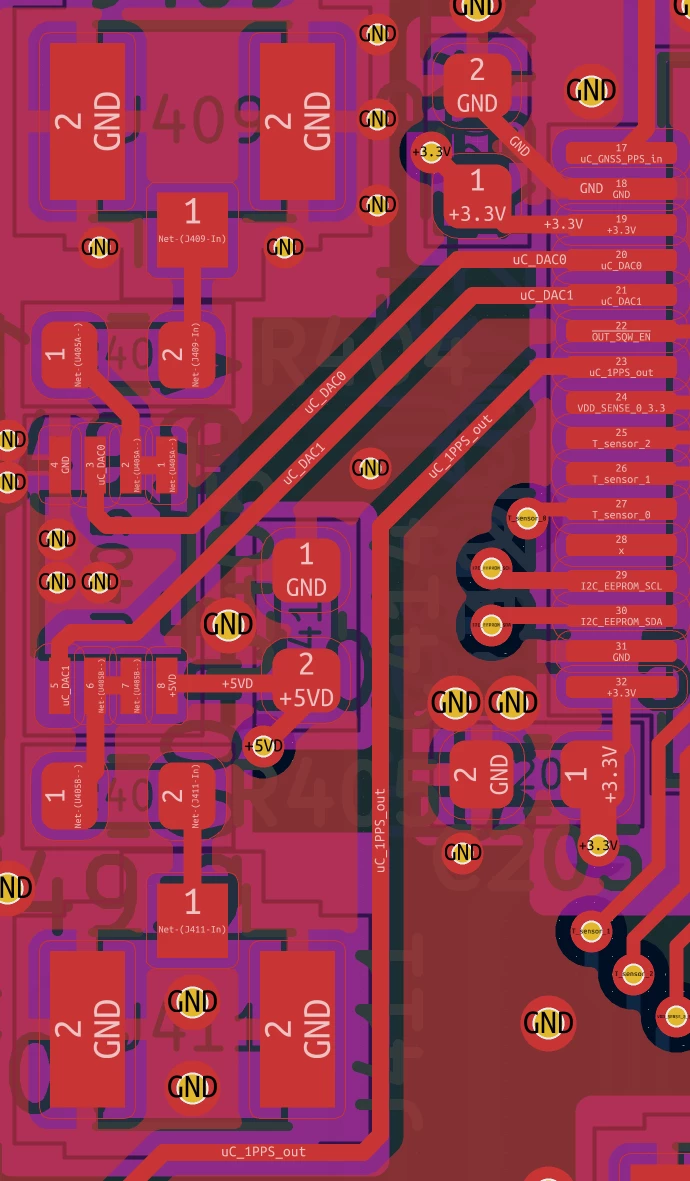

CH4 was connected to the "uC_DAC0" net, directly at the F072's output. The trace is less than 10mm long.

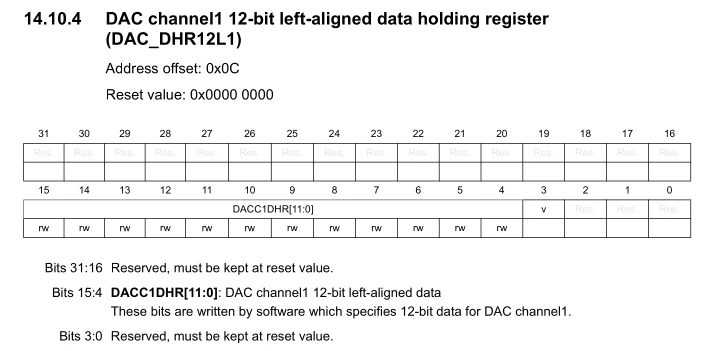

correct. this generates a bit pattern that the DHR12L1/2 registers expect:
@Peter BENSCH wrote:
The DAC may therefore be receiving an effective waveform centred around mid-scale and not using the full range correctly.
This is intentional. Since the DAC cannot output negative voltages, the mean of the SIN must bei at VDD / 2, if the full range is to be used.
or if you keep left alignment, make sure the value is shifted to match the DAC’s expected left-aligned format.

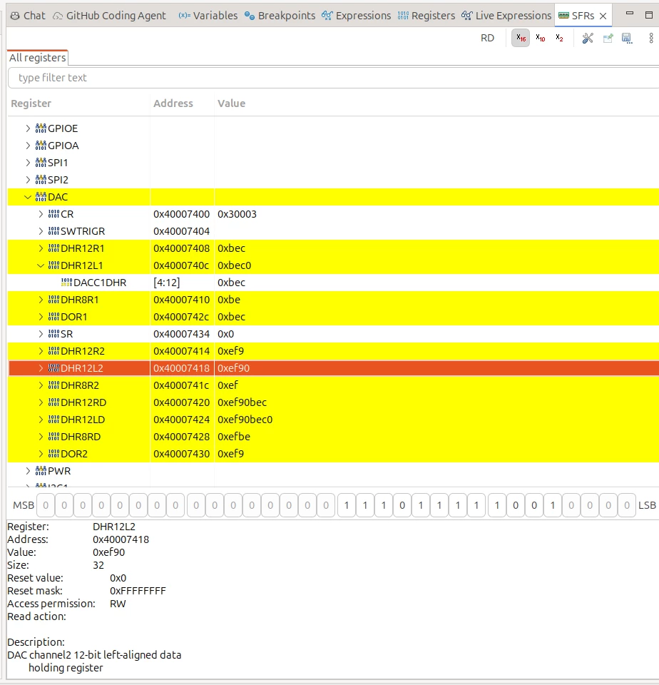

I checked with the debugger, the values range from 0 to 65520, which is the correct range for a left aligned 12-bit value with the lower 4 bits cleared.
Dividing the value by 2 creates a perfect SIN wave centered around VDD / 2.

Op amp specifies typical 7 mV from rail at 10 kOhm load, and 32 mV from rail at 2 kOhm load. Extrapolate that down to 50 Ohm (or 100?) load--much higher. That's likely where your issue is. Everything else seems okay. Remove the load and it pro
Good spot by @MasterT
Not really half VDDA, just kinda close. 54%. Just coincidence. If it were exactly have then scaling issues would be likely.
