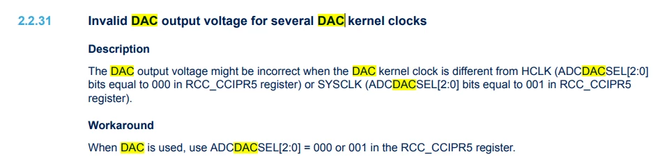

Hello @jeremierafin ,
First of all, I wanted to thank you for your detailed explanation and outstanding detailing of this issue.
after examination of the code and after double-checking the tests that you did i share your assumption about this being a silicon bug most probably related to the STM32H562xx/563xx/573xx device errata - Errata sheet
I submitted a ticket (ticket number 200203 for internal reference only) to confirm this erratum is valid for H523 series as well and will keep you updated.
Regards
This has been confirmed as limitation and will be updated in upcoming Errata revisions. Thank you for pointing this out.
Regards

To conclude: the DAC CAN NOT be clocked by PLL2R (silicon bug).
If, reader, like me, you want to have a "fast" ADC running in same time with DAC, you must set the analog clock switch "ADCDACSEL" to "rcc_hclk" (=SYSCLK), otherwise the DAC is not reliable. And, if, like me, you want a specific sampling frequency ("FS"), but you prefer ADC and DAC to be synchronized (for simplified signal processing), then below are some options:
1) Simpler solution. Configure the ADC in "continuous mode"; the prescaler for ADC gives few (one?) possible FS: with SYSCLK=250MHz, FS can be set to 250/4/15=4.167MHz (The "15" comes from SMP+RES=2.5+12.5 at 12 bit; the "4" is the ADC prescaler from SYSCLK). Furthermore, if you accept a light reduction of CPU power, you may tune PLL1 so that SYSCLK is lightly smaller. For instance, if you target 4.0MHz for FS, you can set SYSCLK=4*15*4=240MHz. For the DAC, a timer, for instance TIM7, must be used. Clocked by SYSCLK, it is perfectly synchronized by DAC (but phase is not controlled). Even if FS can be tweaked by sampling duration (SMP=2.5 by default, but can be set to 6.5, for instance), flexibility for FS is pretty poor. For that reason, the next option is proposed.
