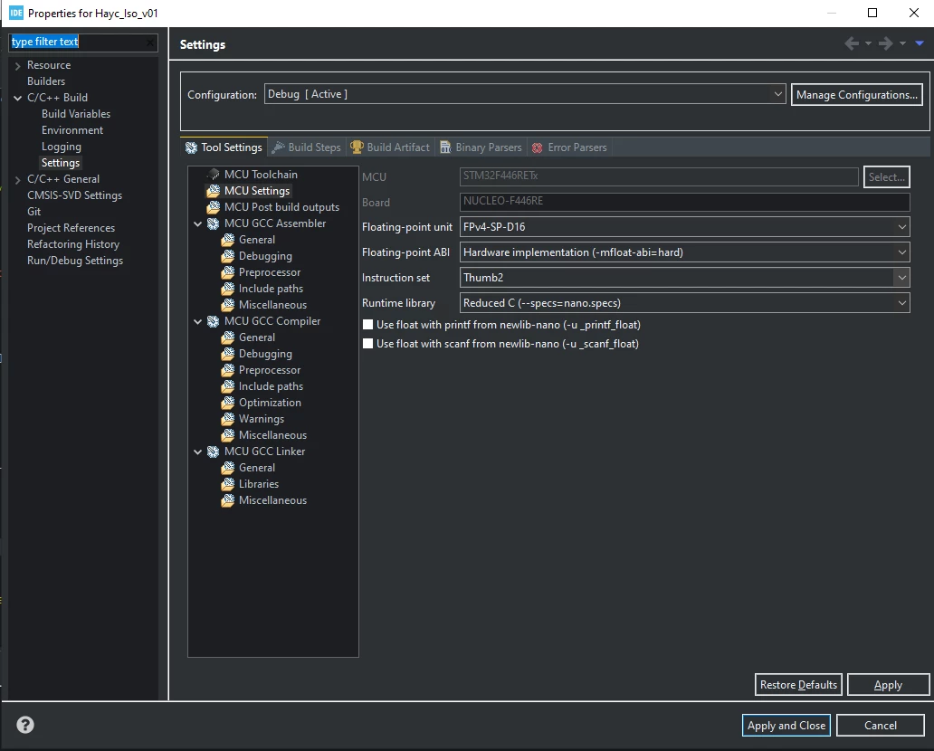

Hi all,
I have a question concerning the duration of float multiplication on the STM32F4. As far as I know, the chip has an FPU.
I run the following code snippet
float LagCompensator_process(LagCompensator_instance* S, float input)
	S->x2 = input;
	LL_GPIO_SetOutputPin(GPIOC, LL_GPIO_PIN_8);
	S->y1 = S->p1 *	(-S->p2 * S->y1 +
					 S->p3 * S->x2 +
					 S->p4 * S->x1
	LL_GPIO_ResetOutputPin(GPIOC, LL_GPIO_PIN_8);
	S->x1 = S->x2;
	return S->y1;
The duration between the Pin Set and Reset is about 170ns. The processor runs on 180MHz.
I find the 170ns for 4 Multiplications pretty long. However, it is with float variables. Can anybody comment on this? Do I have to activate the FPU somewhere in the Project?
In the project properties, you can find
0693W00000QNn4MQAT.pngThanks in advance for your help!

LCE
Principal II
August 16, 2022
It looks like the FPU is active.
170 ns is not too bad, that's about 30 clock cycles at 180 MHz.
There are not only the 4 multiplications, also some adding, and getting data to the GPIOs also takes some cycles.
