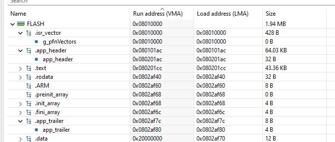

Hi amazing community..
I have developed a custom linker file for stm32f429.
Here there is my costum linker file

When i debug the application the code is running but the ISR are not working.
Here there is the memory map
The idea is to have 64kb for the botloader and the rest for the application.
The starting point of the application it  should be at address 0x08010000
as usual in the main function i do this ..
Can you please tell me if you see something strange on the setting of the ISR table ?
Thanks a lot

Hi @Radosław
Also in my case it is after interrupt..
But I don't understand why the interrupts are not working

However i will try to not touch the isr_vector by modfing the starting address in flash i will remove the bootloader_section and maybe it should work ?

Bootlader section is before ISR? do not mix linker sctripts, Now we talking about aplication linker nor bootloader,
Booloader need standard linker stript, as i;m notice earlier
Bootloader always need info about whare aplication is start it is enough, from this info you can to everything, that why booloader need standard linker script, (or only for claryfication aplication memory region).

Hi @Radosław and @Tesla DeLorean  I have changed the linker in the following way but still isr routine are not working

 * IMPORTANT NOTE!
 * If initialized variables will be placed in this section,
 * the startup code needs to be modified to copy the init-values.
 .ccmram :
 . = ALIGN(4);
 _sccmram = .; /* create a global symbol at ccmram start */
 *(.ccmram)
 *(.ccmram*)
 . = ALIGN(4);
 _eccmram = .; /* create a global symbol at ccmram end */
 } >CCMRAM AT> FLASH
 /* Uninitialized data section into "RAM" Ram type memory */
 . = ALIGN(4);
 .bss :
 /* This is used by the startup in order to initialize the .bss section */
 _sbss = .; /* define a global symbol at bss start */
 __bss_start__ = _sbss;
 *(.bss)
 *(.bss*)
 *(COMMON)
 . = ALIGN(4);
 _ebss = .; /* define a global symbol at bss end */
 __bss_end__ = _ebss;
 } >RAM
 /* User_heap_stack section, used to check that there is enough "RAM" Ram type memory left */
 ._user_heap_stack :
 . = ALIGN(8);
 PROVIDE ( end = . );
 PROVIDE ( _end = . );
 . = . + _Min_Heap_Size;
 . = . + _Min_Stack_Size;
 . = ALIGN(8);
 } >RAM
.app_trailer :
 . = ALIGN(16);
 _app_trailer = .;
 KEEP(*(.app_trailer)) /* Application Trailer */
 . = ALIGN(4);
 _app_fw_end = .;
} >FLASH
_app_fw_size = _app_fw_end - _APP_FW_START;
 /* Remove information from the compiler libraries */
 /DISCARD/ :
 libc.a ( * )
 libm.a ( * )
 libgcc.a ( * )
 .ARM.attributes 0 : { *(.ARM.attributes) }
Can you help me whta i am doing wrong now ?
Thanks
